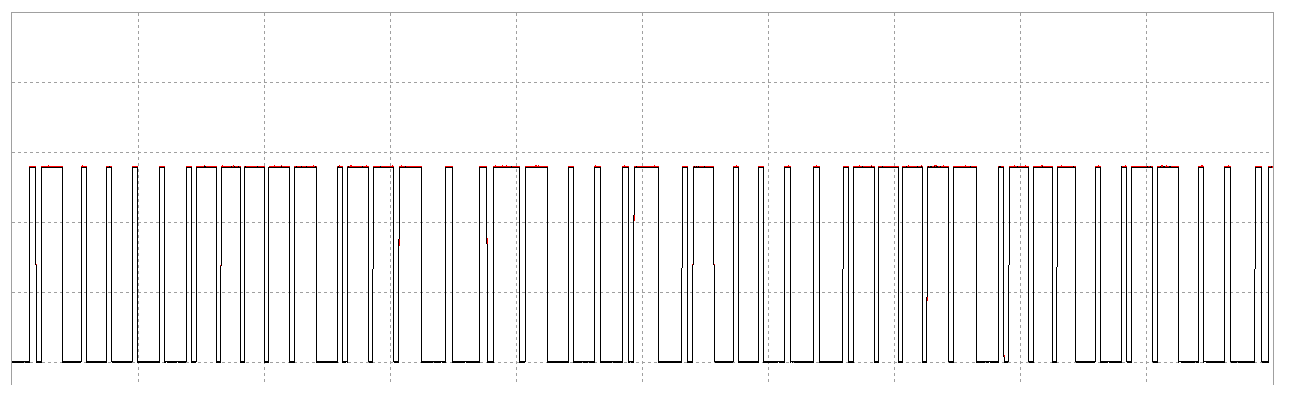

Please do a ref/sync capture. Please name it something relevant and not "ref sync capture", I have a million of those.
Let's go back to basics and work from there. You cannot just set the number of ref teeth to whatever gets the engine to do something, this is just leading down a path with no happy ending. The original LS1 mode is definitely 24 teeth and the later is 60-2 so 12 teeth is not going to help anything.

Postby Tom H on Thu Aug 30, 2018 10:58 pm
ref capture attached
these are old files but are still current
will do a new capture on the weekend
ref capture from tom.rsc2
motec file
png file
ref capture from tom.png (32.49 KiB) Viewed 9275 times

Postby stevieturbo on Fri Aug 31, 2018 7:23 am
Looks like a 24x LS1 crank wheel....you might want to go looking for the cam trigger though.

Postby MarkMc on Mon Sep 03, 2018 10:46 am
You have the Crank Ref Teeth set to 12 when it needs to be 24. Make sure you reset the ECU when changing this on line (press R for reset).
