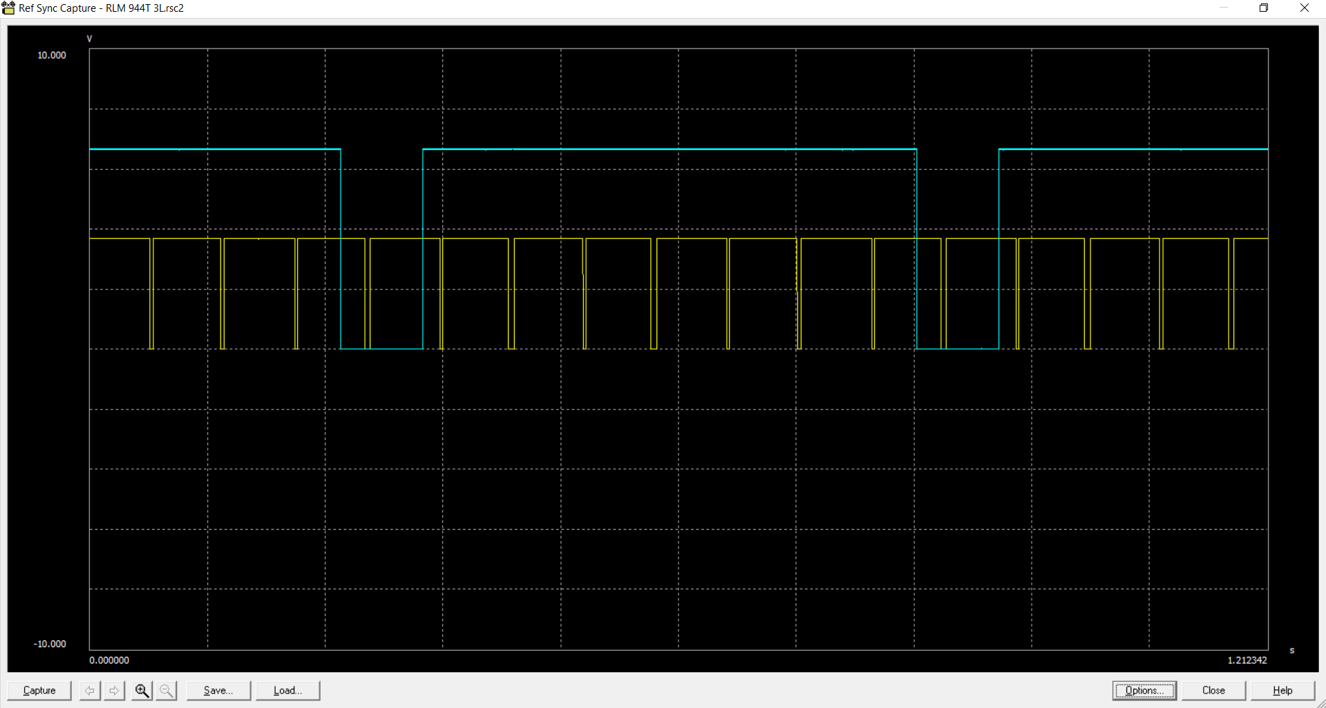

I would start with doing a Ref Sync Capture and seeing what the signal looks like. If you have a Ref Sync Capture from when the engine was running without the errors, it would be good to be able to compare them as well.

Postby rlm on Fri Sep 08, 2017 4:53 am
I am attaching 2 files. the requested RSC file, and the Logged Data file.
RLM 944T #L RSC.png (64.2 KiB) Viewed 24128 times
