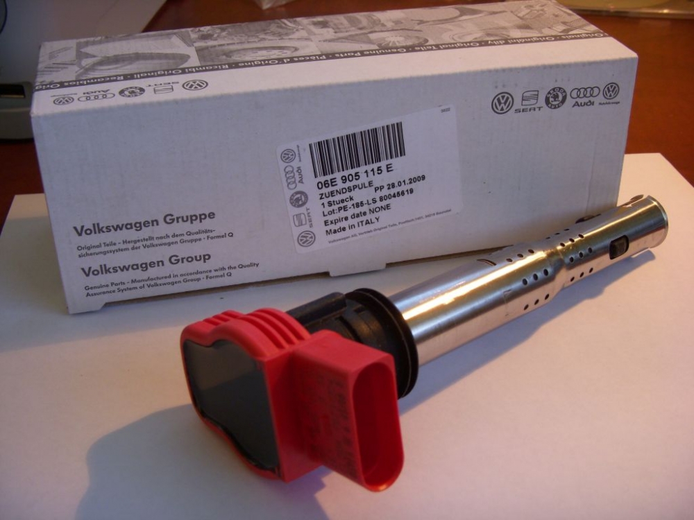

Postby Scott@FP on Mon Oct 31, 2016 2:42 pm
What coils? Make sure the coils do not have a high current power ground (primary or secondary winding) put on the ECU sensor ground.
Scott@FP
Posts: 421
Re: M84 2JZ Install
Postby Vlad on Mon Oct 31, 2016 6:13 pm
Scott@FP wrote:What coils? Make sure the coils do not have a high current power ground (primary or secondary winding) put on the ECU sensor ground.
I have both logic and power gnd of the coils, grounded on the engine block. Coils are red audi rs4 (TFSI WAG coils, 14amps) I use these coils allot because they don't need more than 1ms charging time.
