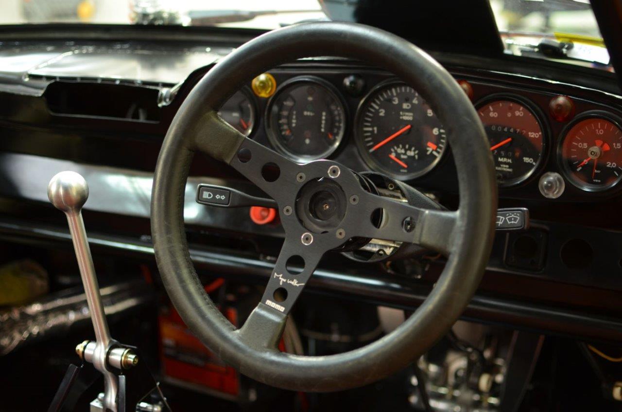

Now exploring the options to "drive" the original "Porsche" gauges out of the outputs of the M190, C187 and / or PDM's. I like to retain the "OLD SKOOL" look of the dash and avoid a double set of sensors to input MoTeC and Porsche / Stack gauges separately and having a Christmas Tree of sensors on the engine and gearbox. The sensors on the engine and gearbox / transmission will be of "Motorsport" grade while retaining the original Porsche fuel level sender and oil level sender. In addition, a set of IDIOT Lights on the Dash needs to be driven out of MoTeC as well, 5 units; Low Fuel, Alternator, Oil Pressure, Fan Belt & Launch Control "ACTIVE".
DASHBOARD
Gauge 1, Fuel Level Tank & Oil Level Tank
Gauge 2, Engine Oil Pressure & Engine Oil Temperature
Gauge 3, Tachometer
Gauge 4, Speedometer
Gauge 5, Boost (Mechanical - pressure line from manifold)

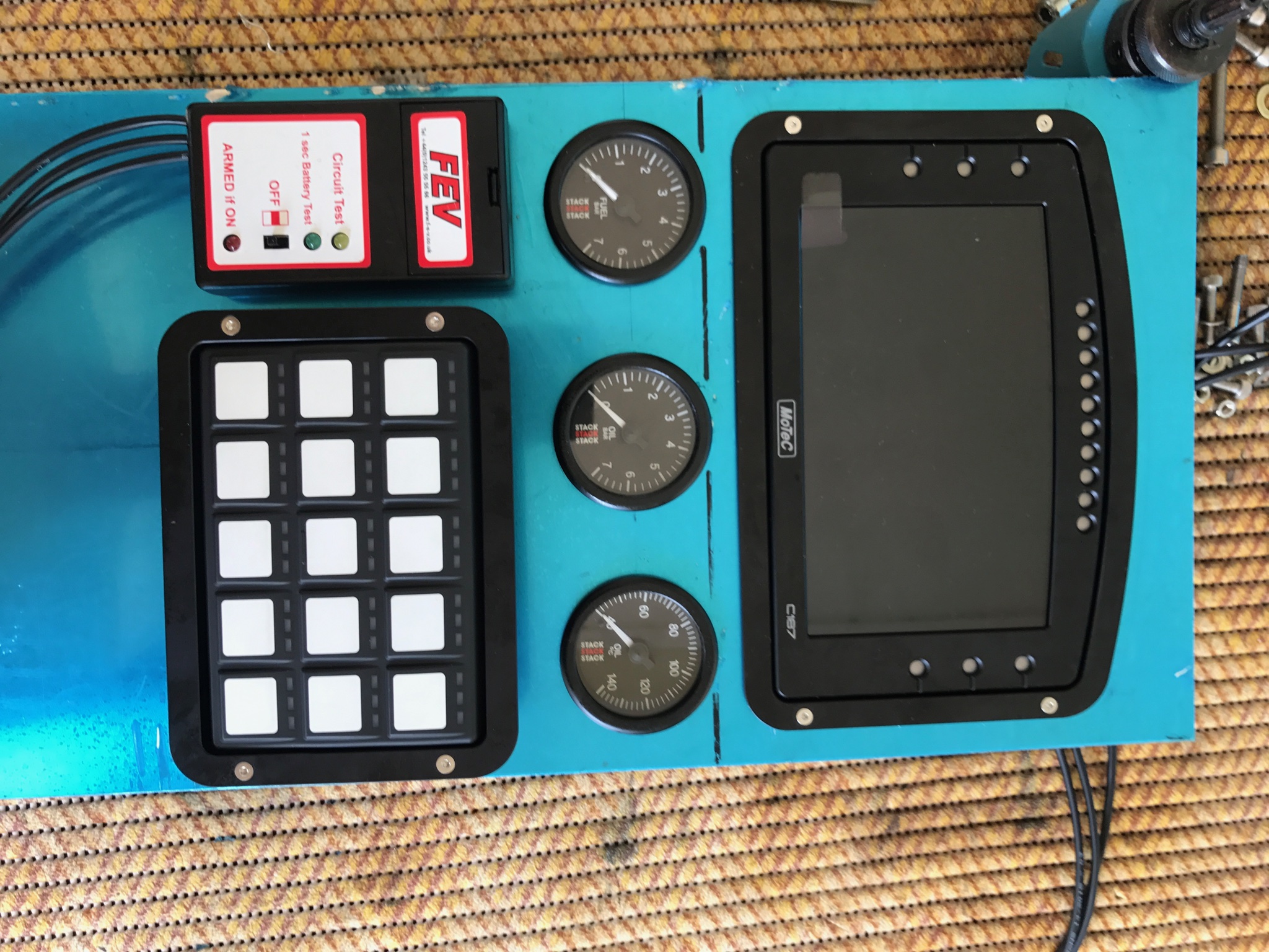

In addition the centre console will hold additional gauges (refer to attachment IMG_7020) for mock-up. The brand of gauges is "Stack" and will backdate the dial-face and hands to VDO period correct appearance at a later stage when all is working as it should. Same here, like to drive them out of MoTeC and "Motorsport" grade sensors and eliminate the original Stack sensors.
Gauge 6, Fuel Pressure
Gauge 7, Transmission Oil Pressure
Gauge 8, Transmission Oil Temperature
In case technical info is required on the Porsche Gauges and Stack Gauges, please let me know and will add the data to this post.
