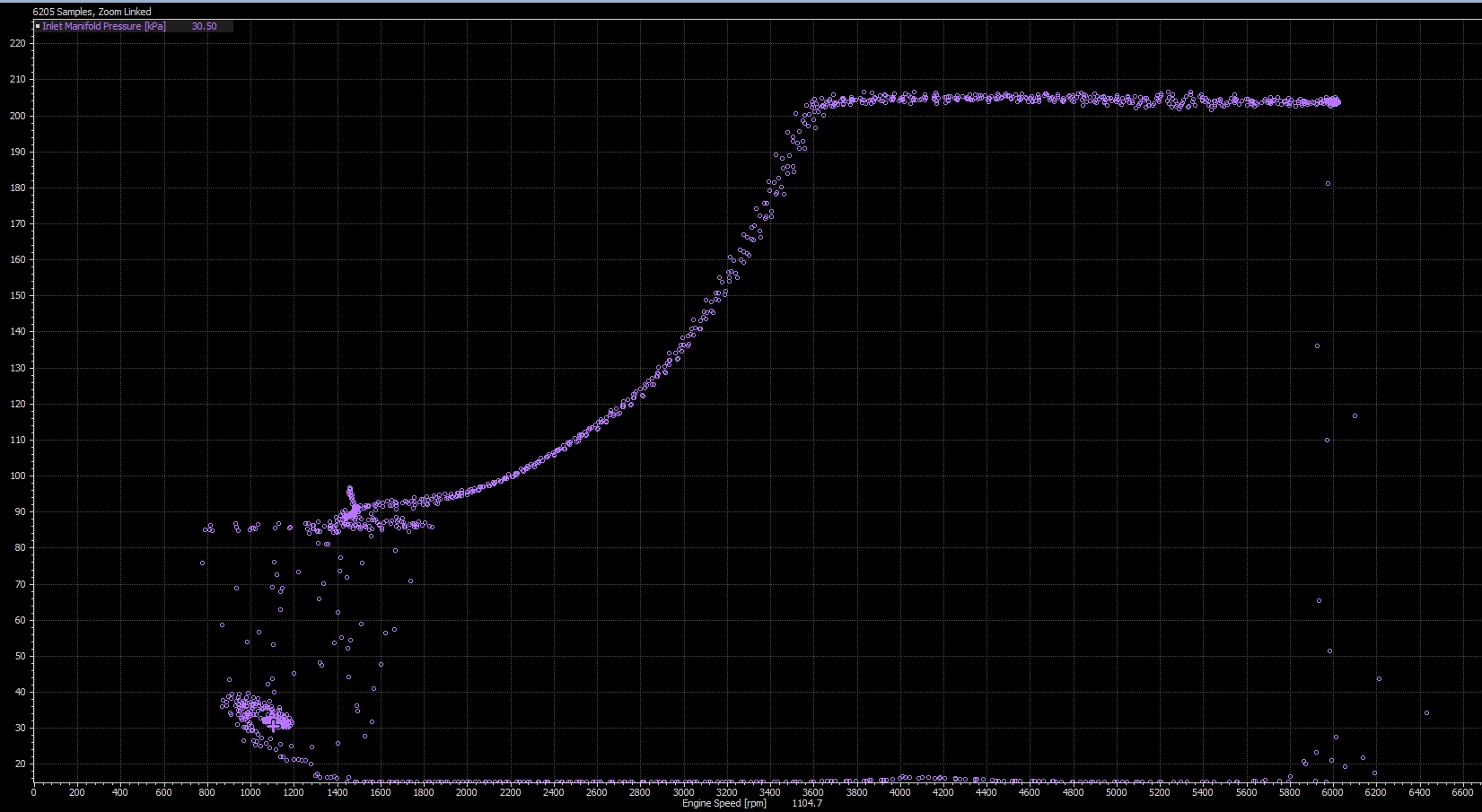

This is the same as the N14 setup but with the newer engine
See the exceptional work of the M1 Boost control. WIth all the visible information PID boost control has never been easier to set up. This scatter plot is the 1st time the engine has run and its after about 15 minutes spent on PID setup for the closed loop boost control.
Garrett GT28 Turbo with internal wastegate
