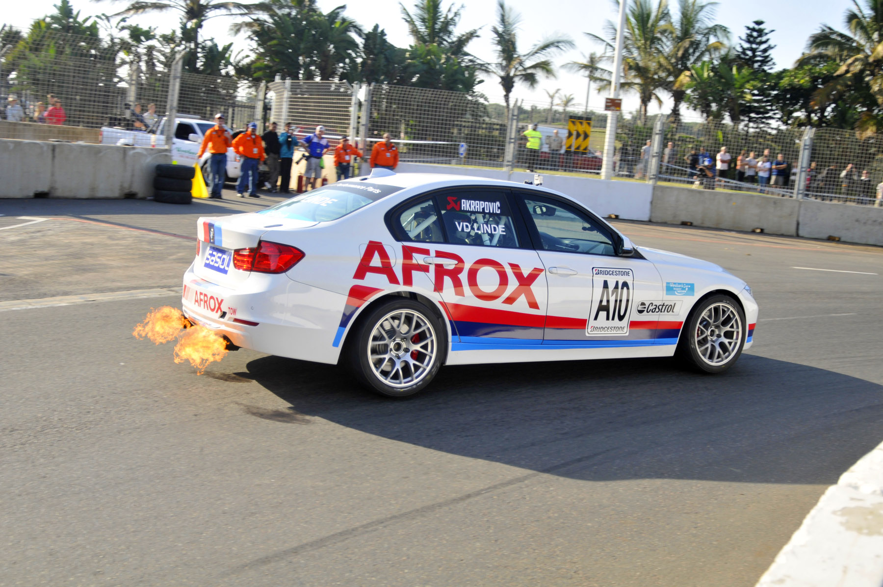

BMW F30 race car
Fully Motec equipped car, including M182 that runs the direct injected N55 engine.

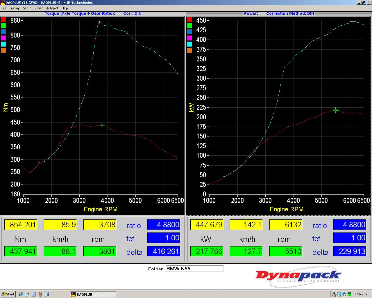

The F30 race cars are boost limited and also runs a restrictor for the series rules. Ive done one unrestricted and we have manged this with 1.25bar and no restrictor. The overlay is an OEM N55.
The M182 graph is also OEM engine except for Borg Warner EFR Turbo, Intercooler, exhaust and the M182 of course.
Injectors and DI pump are stock.

Postby 20B on Mon Mar 04, 2013 4:43 pm
854 NM of torque :shock:
Really ?

Postby Martin on Mon Mar 04, 2013 4:53 pm
Yes, all OEM engine.
Mods are:
Bosch 044 lift pump to supply DI pump
M182 ECU
Borg Warner EFR Turbo with external gates (Twin scroll)
Aftermarket Intercooler
Custom Exhaust header to fit turbo with Akrapovic silencer box.
DI Pump, stock
Injectors, Stock,
With a single scroll variant of this turbo it will spool later but flow better at the top. Note the spool of the M182 engine versus the OEM engine.
