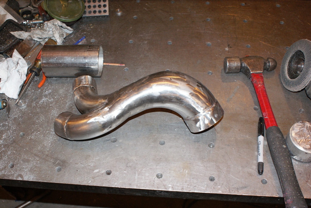

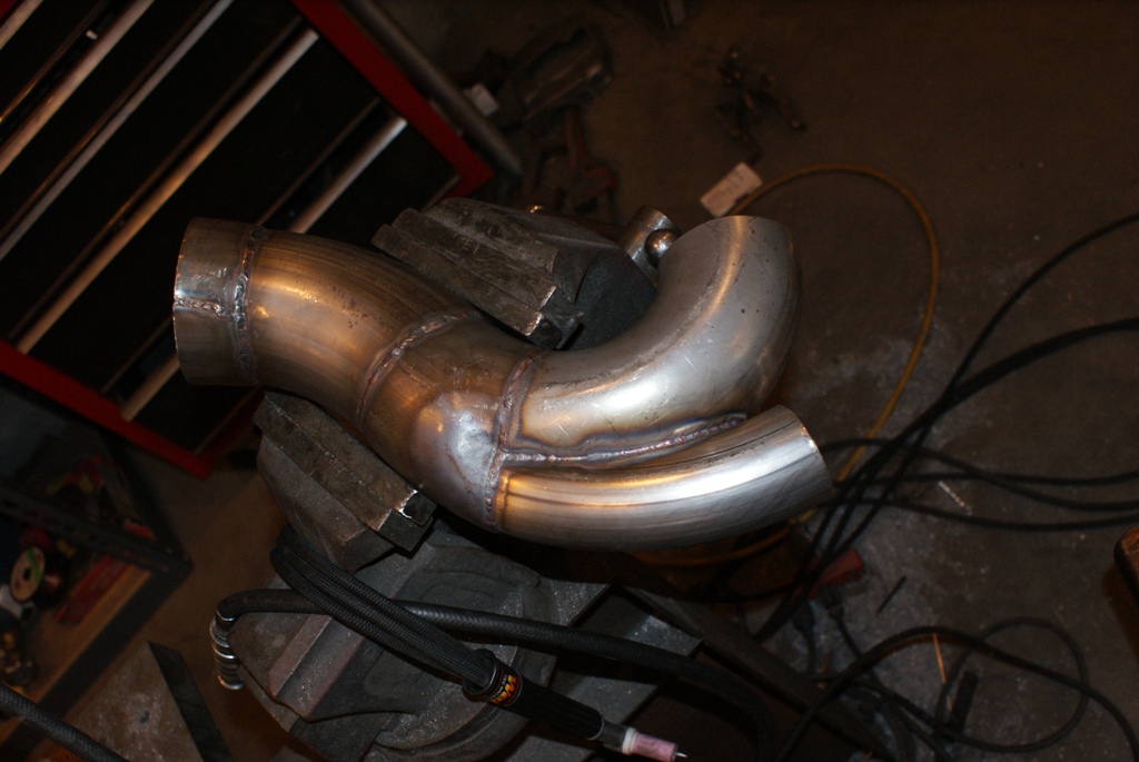

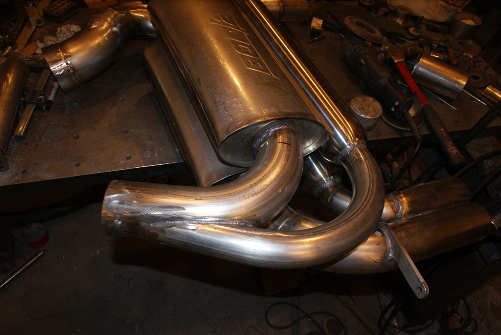

I'm finally back to the ferrari.
The mufflers are not connected and I'm starting to add the O2 bungs...all 4 of 14 are done and don't look too bad. I still need springs at all the slip connections then once all the weld is done I want to do a final trim on the tips and polish them up.
2015-10-17 002.JPG (281.1 KiB) Viewed 37670 times
2015-10-17 003.JPG (345.52 KiB) Viewed 37670 times
2015-10-17 007.JPG (302.06 KiB) Viewed 37670 times
mk e

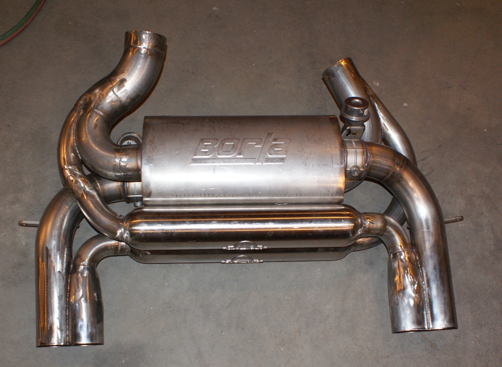

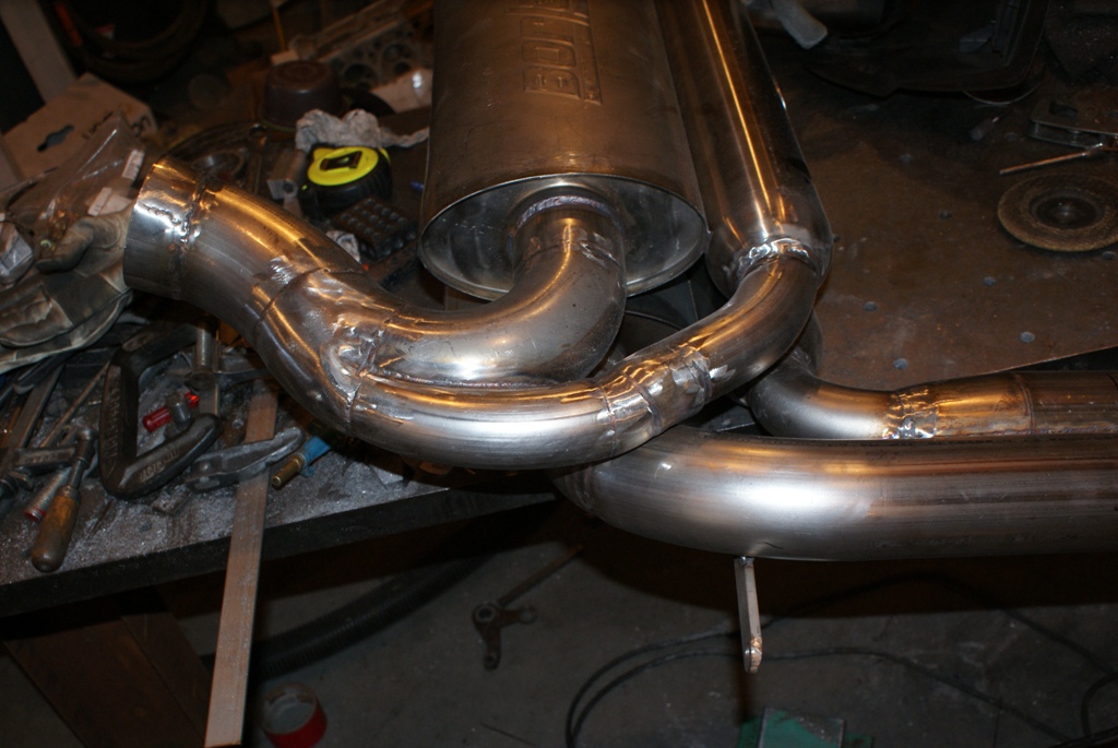

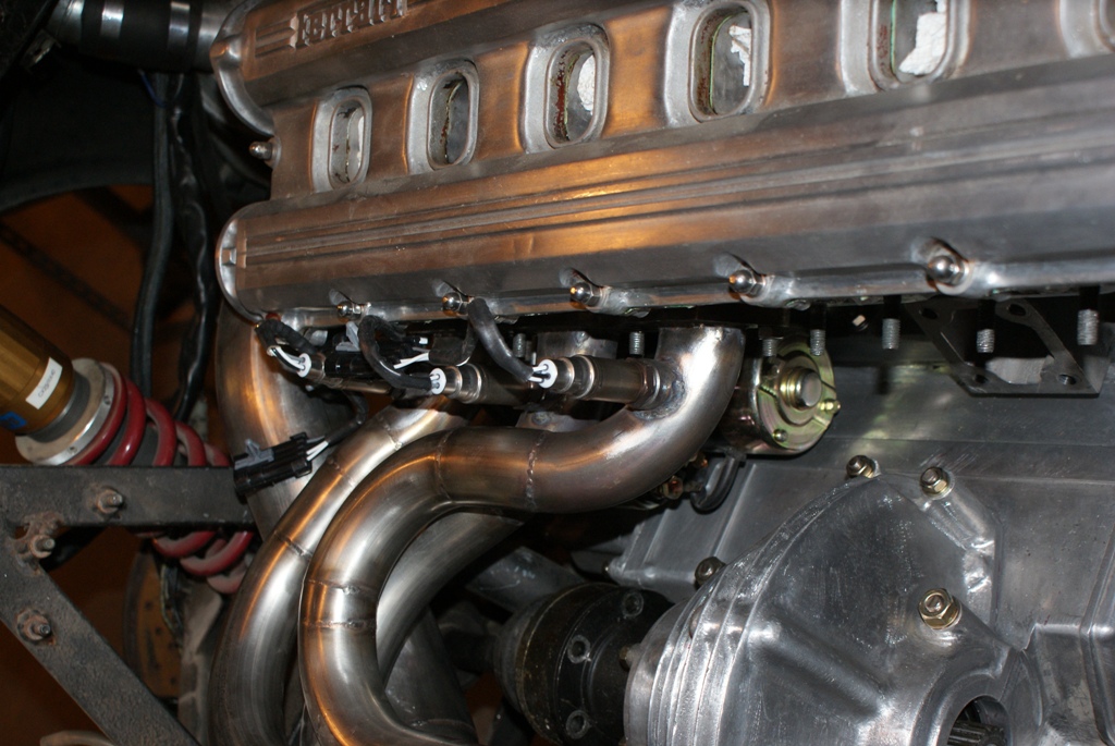

Postby mk e on Sun Oct 18, 2015 9:17 am
A couple more pics
2015-10-10 004.JPG (241.36 KiB) Viewed 37670 times
2015-10-10 007.JPG (263.08 KiB) Viewed 37670 times
2015-10-17 001.JPG (344.68 KiB) Viewed 37670 times
mk e
