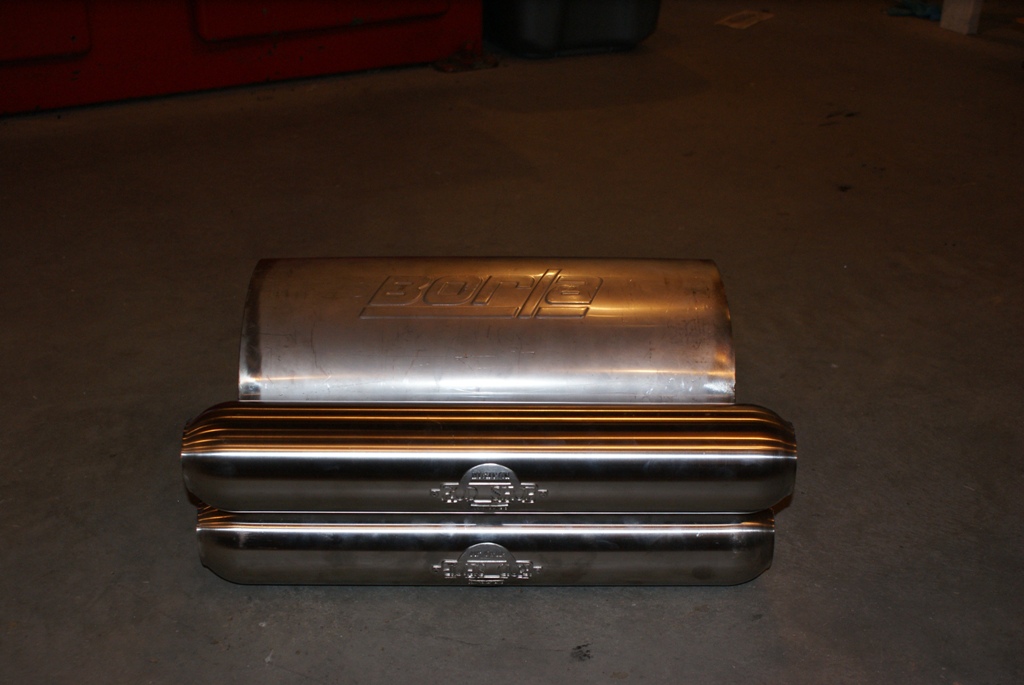

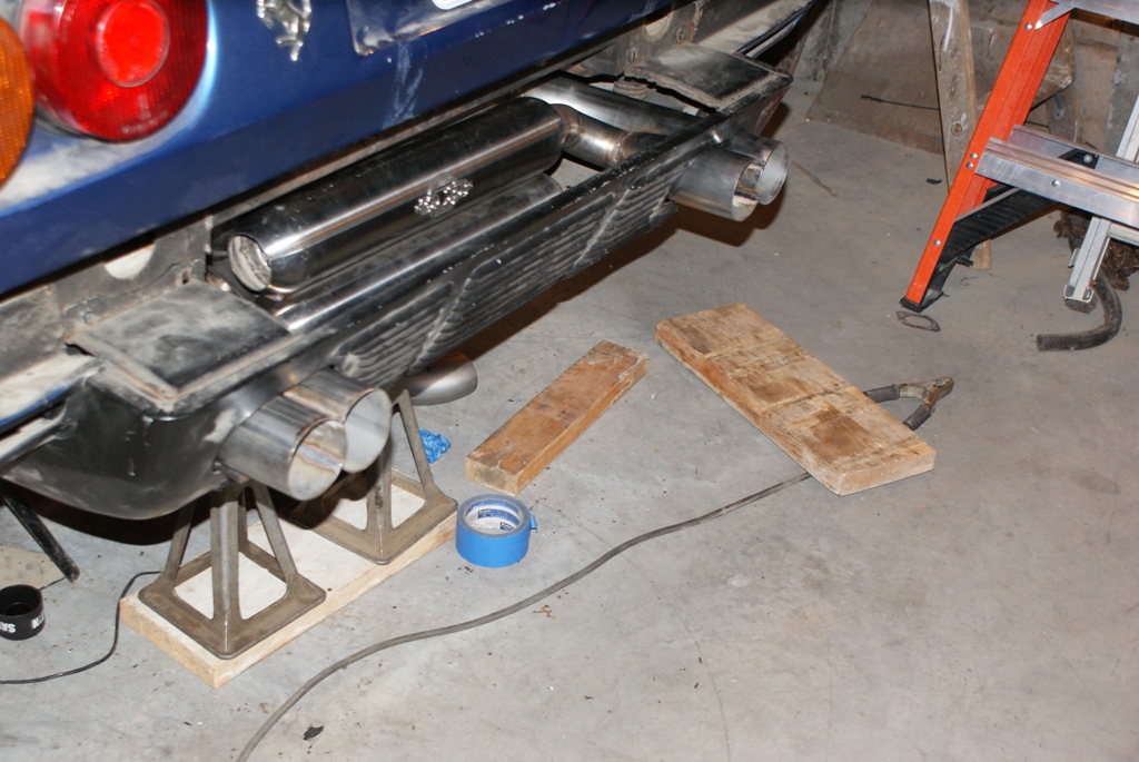

In other news I have a muffler build....I just need to actually connect it to the engine :)
This is a street car and I live in suburbia so it's got to be relatively quiet.....but its also supposed to make about 900hp, or 1004hp if the latest dynomation5 update is to be trusted so a lot of flow.
I have 4 muffler, 2 for each bank. For quietish I bought plain ole perforated core muffler 2 with 2" pipe from these guys:
http://www.stainlesssteelmufflers.com/350mufflers.htm
The for hp I have 3" borla xr1 race mufflers. I did go with the multicore hoping they'd actual muffle a bit.

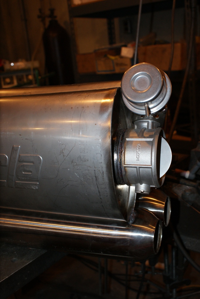

Then I added by-pass valve to the borlas that will be ECU controlled.
http://www.quality-tuning.com/exhaust-vacuum-valves
I want the car to keep a stockish 4 chrome tip look so I wanted to stay with 4 tip through the stock cover....so I made siamesed 3" tips that I'll polish

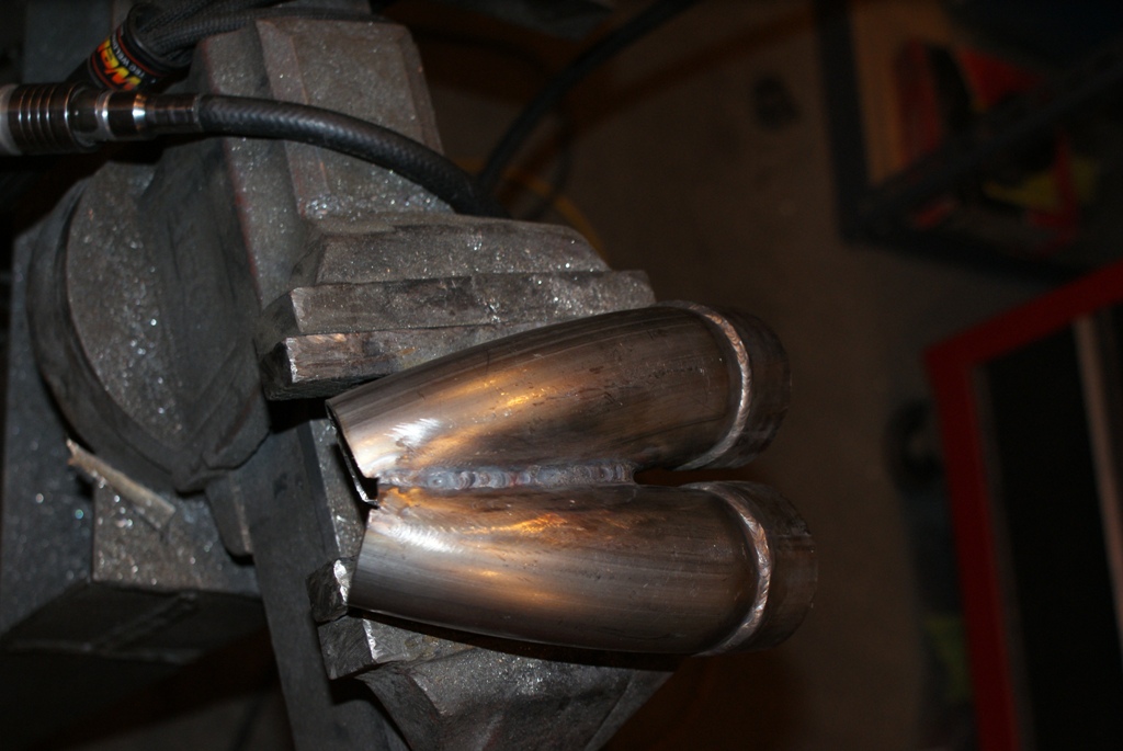

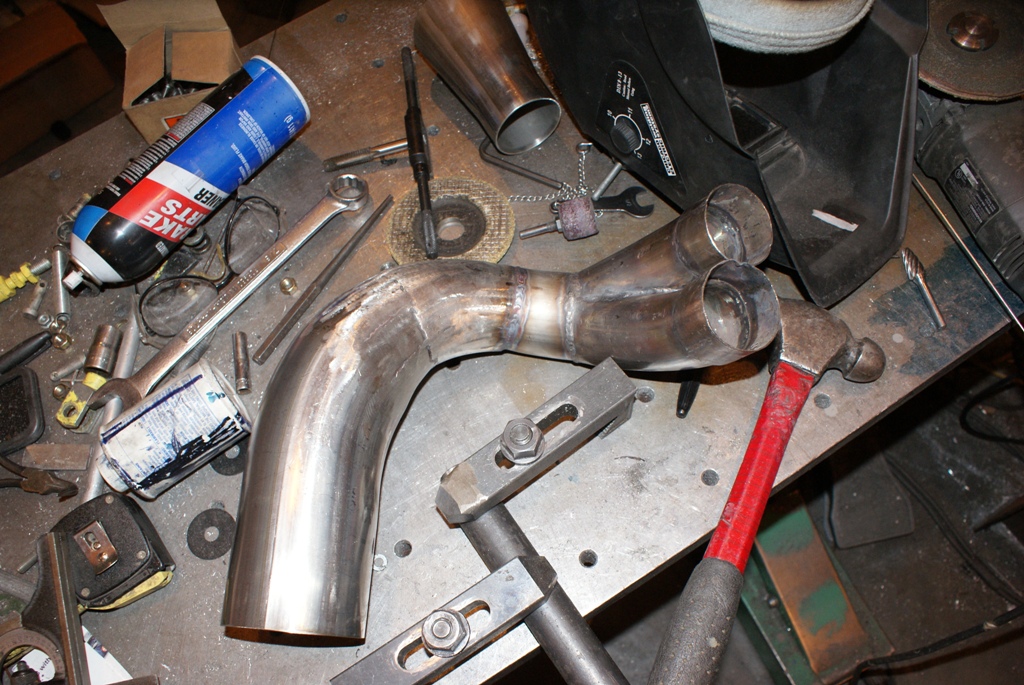

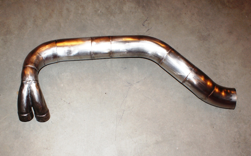

The exhaust is 6-2-1 and the 1 needs to be 3.5" pipe all in a relatively tight space so basically all the collectors landed on bends and I had to make them instead of buy them :(
Here's the 2-1 to out pipe for the front bank or the collector from hell as I refer to it :o
