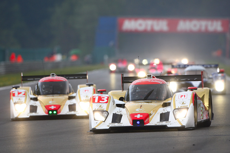

Here are the two Rebellion Racing LMP1 Prototypes. V10, 5.5 litre, 700 Hp (through 2 x 33.5mm restrictors). They utilise Motec engine management, ACL Data Logging, 4 x VIM's, PDM32 and PDM16 providing dual starter and battery capability,MDD/SLM Steering wheel and Motec Telemetry. They are competing in the Le Mans Series, and #13 currently lies second in the championship behind the works #7 Audi-Diesel. Next outing is the Le Mans 24 hours on 12-13 June. Next Le Mans Series Championship round is at Portimao in Portugal on 14 July. The cars are prepared in Surrey, England, although are entered under a Swiss banner in deference to the team owners. Engine's are Judd V10, 5.5 litre. All of the Motec systems and vehicle electronics were prepared by Incontrol Engineering in UK, a Motec distributor and engineering consultancy. For more information on the cars visit www.rebellion-racing.com

very impressive Steve... Ill actually be there this year, so Ill certainly keep an eye on them, I hope that they do well.

Steve,
Impressive!
What do you mean with the above quoted statement?

Hi Martin
The dual battery and starter system allows the car to run a normal single battery, but for starting a second battery is switched in to allow for faster cranking options, and also runs 2 starter motors for the same reason, this also allows the car to be started in gear in case of a clutch failure. The Le Mans regulations enforce that you can only start the car from onbaord and without a jump battery, so this system ensures that the starter systems are, as far as possible, always in prime condition. The second battery can also be used in case of a primary battery failure, or alternator failure. We managed to run for almost 3 hours after an alternator failure in a 6 hour race, which allowed us to finish the race without any unscheduled pitstops or servicing which would have affected the finishing position.
