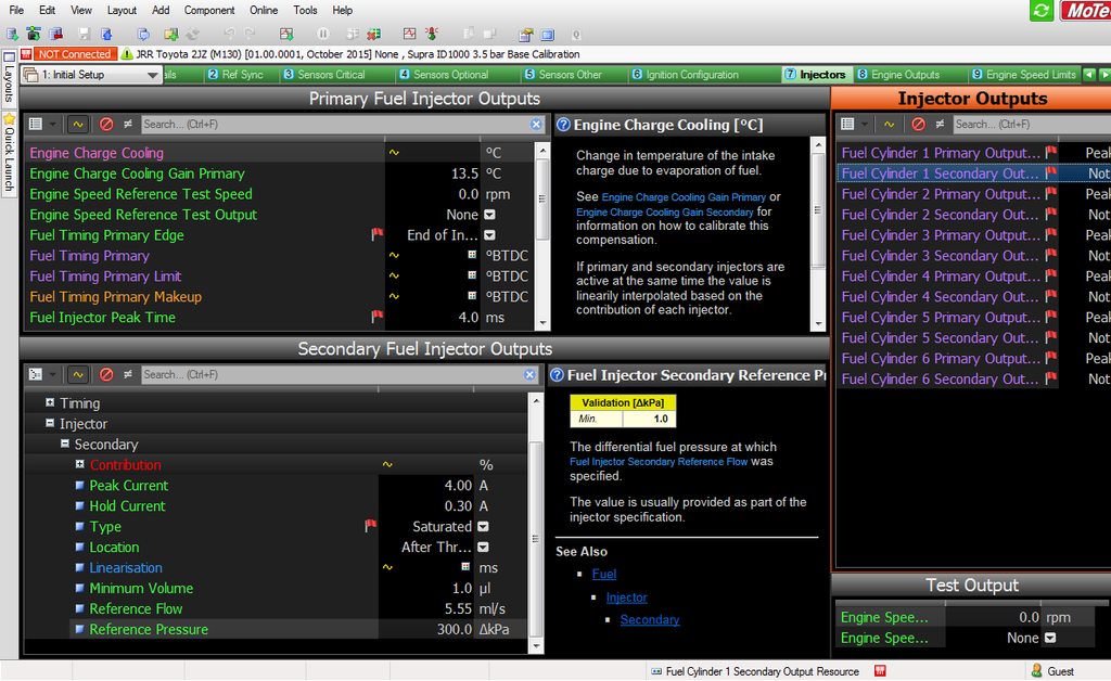

Postby CarloL on Tue May 03, 2016 8:04 pm
Hi Stephen
Here is a Base map John has , I dont see a drop down list to select the injector i.e. ID1000
Looking at the calibration I taught the mapper will just fill in the relevant parameters , maybe based on values you supply to the mapper, if so do you have a list of what injectors you have characterised, so I can verify whats available and best suited for my setup?

Postby CarloL on Tue May 03, 2016 10:44 pm
What about using a simple Voltage table with the OE Injectors?
