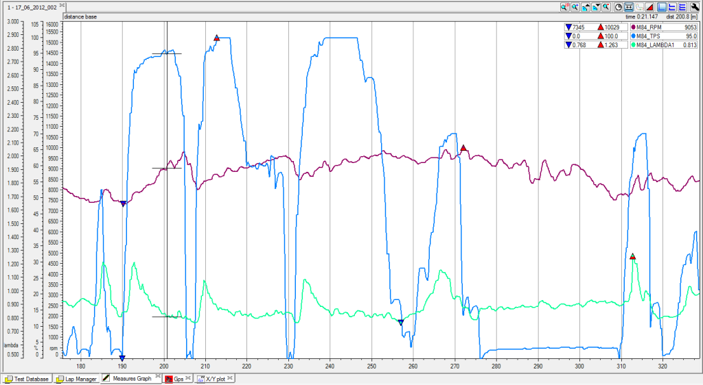

RPM is maroon
TPS is blue
Lambda is teal
the first one here is a capture from our data before comp at a local auto X event
to me it looked like lambda was really getting rich after the throttle blip to shift gears telling me the decel comps weren't quite right and then it would also go lean once the throttle was opened back up, showing that the accel comps were not set correctly.
