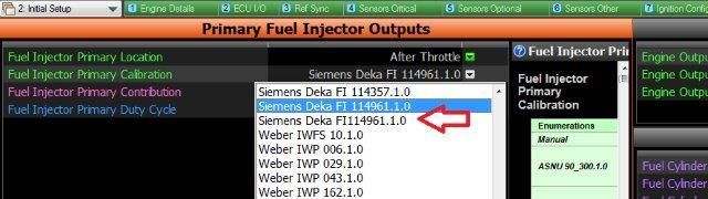

Postby CarloL on Wed May 04, 2016 9:30 pm
Harky if you download the M1 Tune software and the GPR (M150) 1.07 February 2016 M150 402 23072
package , you can see the list of all injectors characterised
Package
https://moteconline.motec.com.au/Package
Make sure you have the latest package updates, The green box in the top Right Hand corner of M1 Tune is the Updates notification, if you click on that and install the updates listed in all of the tabs
Drop down list of injector Calibrations under Fuel Injector Primary Calibration and Fuel Injector Secondary Calibration parameters, this is found in 2: Initial Setup | 8 Injectors.

Postby CarloL on Thu May 05, 2016 12:39 am
Hi Stephen
The Siemens Deka FI-114961 is in the list twice (630 cc)
Should one of the setting be for the 840cc ? Siemens Deka FI-114991
I am hoping its a Typo :D

Postby Stephen Dean on Thu May 05, 2016 10:11 am
Thanks for the spot there!
I have passed it on to the engineers to investigate and resolve.
