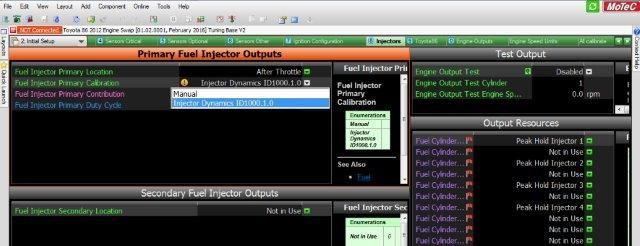

It is set for ID1000, my question was in regard to the drop down list to select the injector; Stephen said there is a drop down list of supported injectors but I cannot find one
I was wondering what injectors are characterised , incase I have to purchase new ones

Since this package is based from the earlier firmware, the "drop-down" list of injector isn't present. The complete injector characterization does look like it's there based on your screen shot. So you could "import" the tables values for whatever injectors you had data for.
I think your real question is -- what is the complete list of injectors that Motec has characterized. That is found by loading a package based on the July 2015 or later 1.04 firmware and then looking at the pull-down list. When I do that, I see ASNU (11 models), Bosch (71 models), DeatschWerks (6 models), Delphi (2 models), Denso (53 models), Finjector, Five O Motorsport, Fuel Injector Clinic (2 models), Fuel Injector Development, Grams, Hitachi, Injector Dynamics (4 models), Kawasaki, Keihin (13 models), Kia, Lucas, Magneti Marelli, Mitsubshi (3 models), Moran (9 models), MPC, Nissan (3 models), Precision (2 models), RC, Rochester (2), SARD, Seimens Deka (19)Weber (6), XSPURT.

I tired a few Packages from here https://moteconline.motec.com.au/Package
All I can see in the drop down is ID1000 or Manual

Postby Stephen Dean on Wed May 04, 2016 6:23 pm
Hi Carlo,
That green box in the top Right Hand corner of M1 Tune is the Updates notification, if you click on that and install the updates listed in all of the tabs, then you will see the other calibrations that are available to you.
