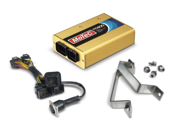

This is to advise we now have stock of looms and brackets for the FXSHO
This kit is about to be released however we are just waiting on the new KTC (K line to CAN)
This new product will be attached to the adapter loom and serves as a communication converter.
The KTC device will in the case of the Yamaha convert the M400’s out going CAN data stream into a K Line data stream.
This is done so that the factory dash can receive rpm and warning information from the M400.
Prototypes have been successfully tested and we are now waiting on production run units to arrive.
Jetski kit sml 2.jpg (46.58 KiB) Viewed 13836 times
