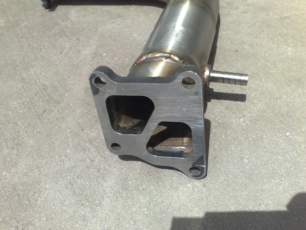

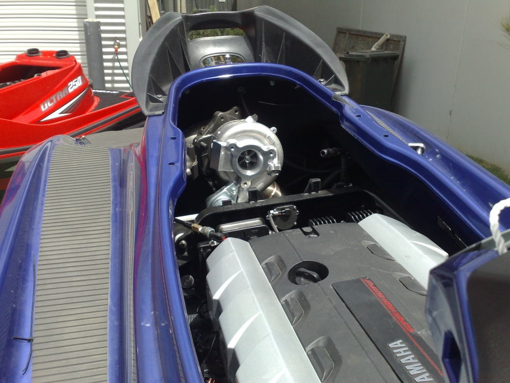

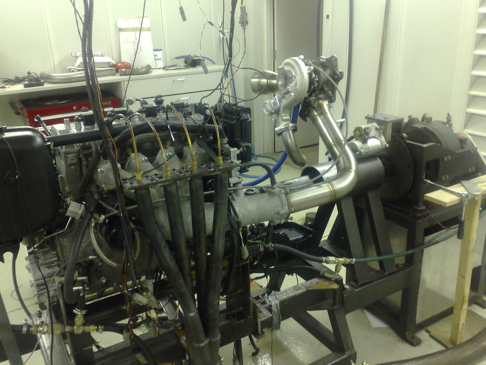

Just a quick note to say we have started on the turbo path for the SHO
Have made a Jacketed manifold to go to the turbo and sorting injectors and rails currently.
Attached is a couple of mock up pics.
Hope to be runing it on the dyno next week, engine still standard at this point so we will be taking it slow.
Our aim will be to have the kit or drawings etc of parts required, available through our dealer network, along with the ECU and loom of cource

Turbo is one of many we have lined up, this one off a Rally car engine, not ball bearing to my knowledge, we will test and see its boost spread and total HP flow on the SHO.
Your right, I am a long way from installed ski issues,although all hardware is being made so that it will bolt straight in and we will try to keep under seat heat to a minumum.
