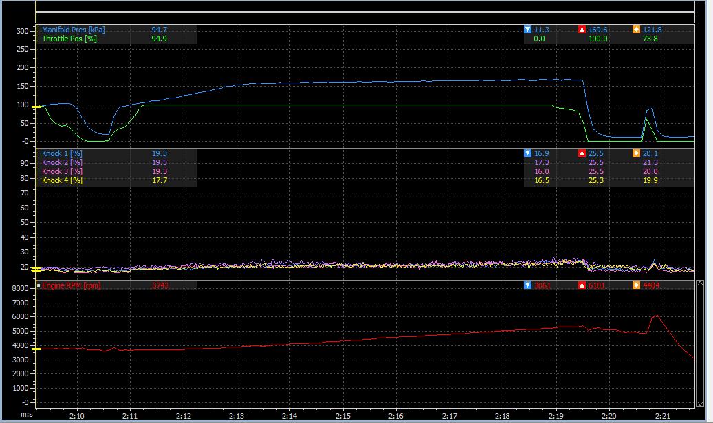

Just for those who are interested, this is a Toyota 2ZZ with SKM fitted.
The second graph is low boost setting
The first graph is where the wastegate actuator pipe was not on the wastegate anymore
Turbo is a GT35
Over boost.jpg (108.82 KiB) Viewed 30187 times
Normal boost.jpg (112.33 KiB) Viewed 30183 times

Postby Martin on Wed Oct 07, 2009 9:08 pm
Yes it did survive.
I set the max retard to 10Deg....10 is clearly not enough to get it to stop rattling. Ill need to make some changes.
Retard gain is set to 0,5......0,5Deg reatrd for each percent over the threshold.
Knock table 27% at 6000RPM....so with 0,5gain its an instantanious retard of 10degs at anyting over 47%, so if I allowed more retard It could have retarted a massive 36,5degs with 100% levels with the gain set to 0,5
Just to clarify,,,,,with the 10 retard it was running after TDC and still knocking. Almost like an EVO :)

Postby Martin on Thu Oct 08, 2009 3:59 pm
It didnt run away...the limiter is only at 8000.
If you want to catch it in a event like this I think using the Long term knock trim to do a DBW reduction trim.
The Long term trim is slower but more stable so suitable for a DBW trim.
