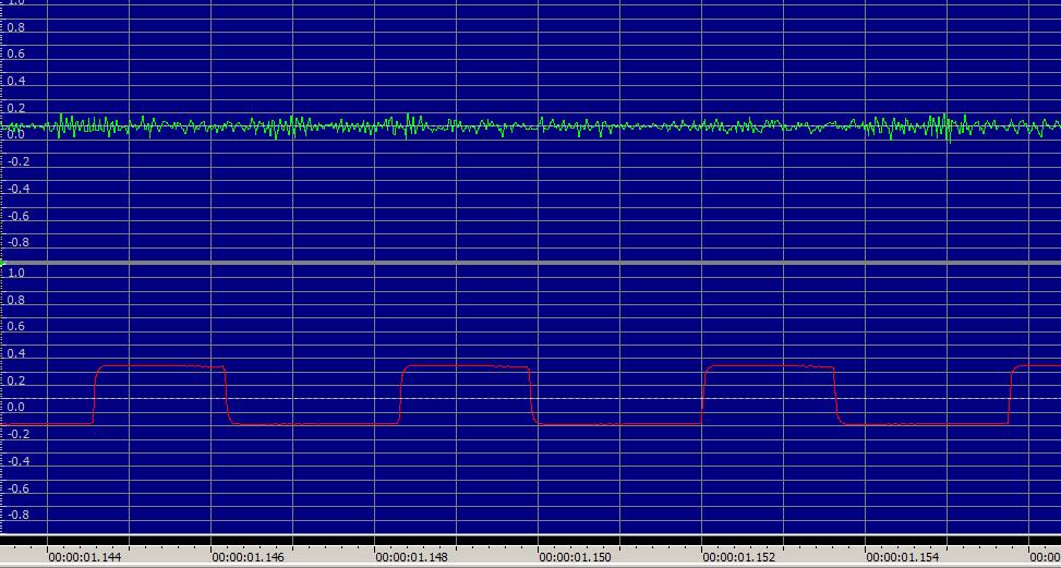

What sampling rate is best for the Goldwave software? My knock window signal is not true square wave (will try and post a screen capture when I can). Starts as a square wave on the rising edge, but then tapers for part of the falling. The actual knock signal data looks pretty normal.
I also get the occasional INJ8 open error, though not all the time.
M800 ECU, waste fire 10 cylinder engine. It is also an odd fire engine if that changes things.

How do you wastefire on an oddfire engine?
Is this a Viper? or a S85?
my sampling rate is 44100

Thanks for the reply Martin. It was my sound card doing it, in the end I found it to not cause me any issues at all.
Viper, and other than the last year or two they have always been odd fire, waste spark.
