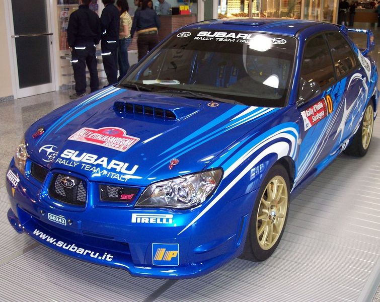

Is knock voltage wired to av5 or La1 on the above mentioned car?
Subaru N12.jpg (109.61 KiB) Viewed 9423 times
Re: Subaru GrpN N12
Postby RossB on Mon Apr 27, 2009 12:42 pm
It is connected to AV5 on a WRX78 M800 Plug-in. Link 16 needs to be cut as per the default link setup.
