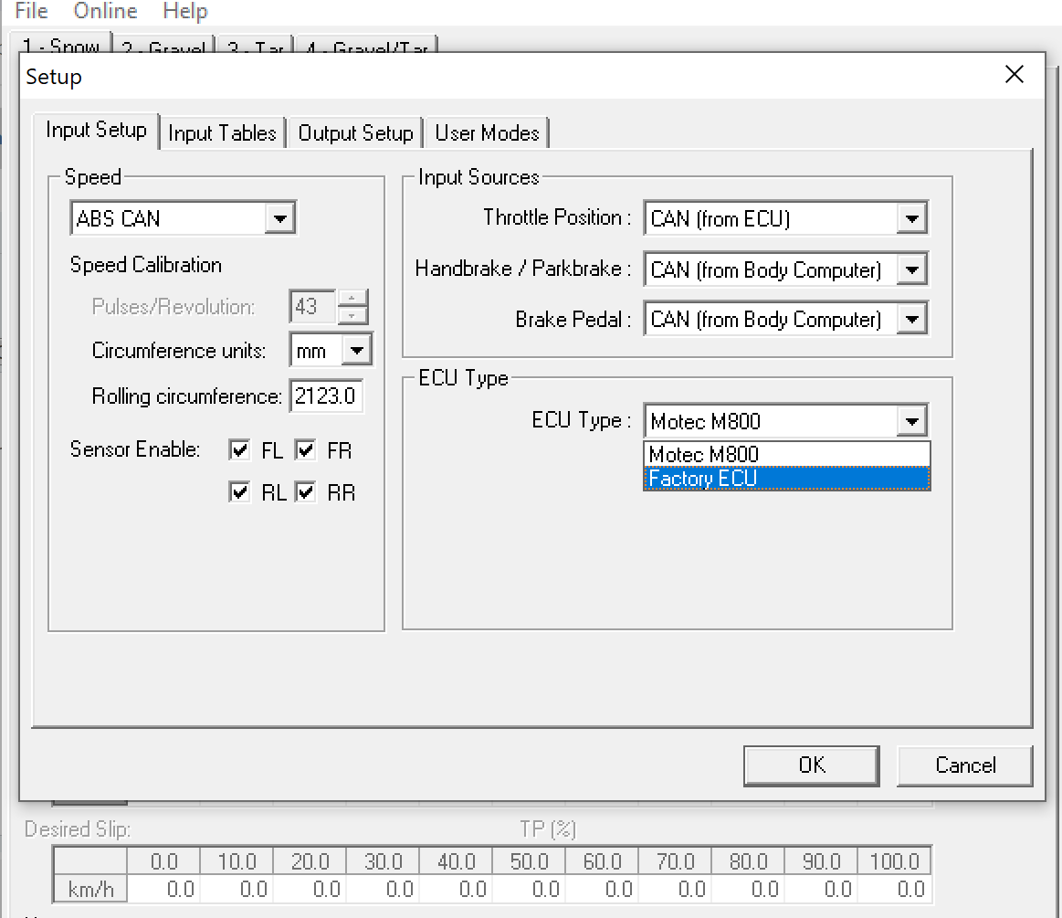

We have a M150 ecu with MDC2, on MDC2 software what we should use ? Motec m800 or factory ecu ?
Whtas the CAN ID for M150 ?

The MDC2 was originally intended to be used either with the OEM ECU or an M800.
Are you using a GP based firmware with your M1 or a partner package?

We use partner package ( EVO X Firmware ) .

Who's Partner Package are you using? You will need to contact them to find out how they have configured the Partner Package to work with the MDC2, if they have provided support for it.
