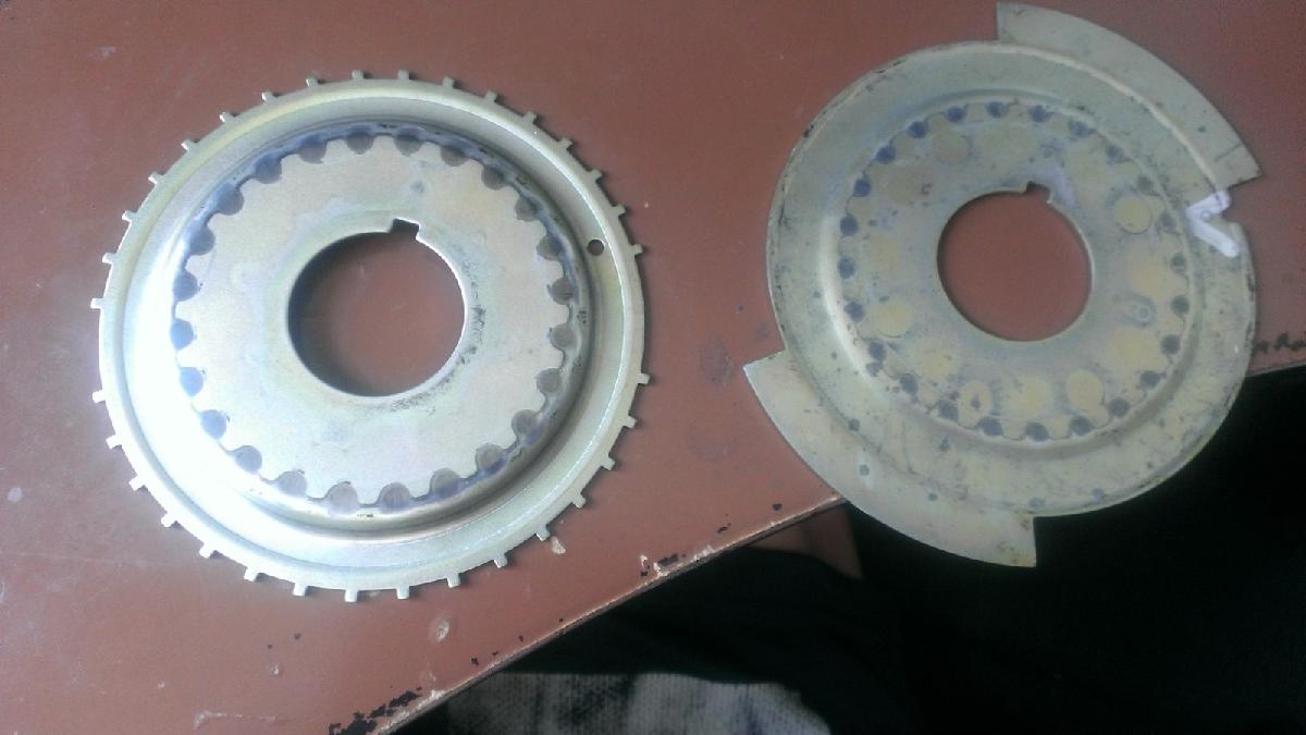

gday guys need some help with a start file for a 4g69,i am using a m84 now not the m48. maybe just some help with ref sync mode the crank sensor is 36-1-2 as pictured on the left

this is the cam sensor

Did you try Mode 46? I know mitsi CZ3 engine is 36-2-1 with a 6 tooth cam wheel but I don't know if the cam teeth have the same pattern as yours.

thanks for that,i inspected a cz3 at work today and it looks the same.i will give that a try
