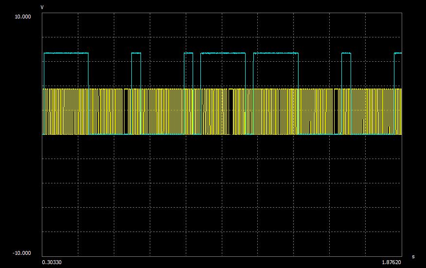

The ref and sync sensors on LS1 and LS2 are also different, but mode stays the same. I know the Ls7 is a 60-2 mode. Is this what the Ls98 uses? If it does, thats mode 17.
ls7 capture.jpg (63.86 KiB) Viewed 46921 times

Postby Martin on Thu Jun 04, 2009 4:28 pm
Thanks IJ
LS2
Ref A Blue Signal
B Yellow 0v
C Red 8v
Sync A Red 8v
B Yellow 0v
C Brown Signal
I know the LS1`s pinouts are diffrent. My guess is that your L98 is just another variation. I dont see a lot of LS1`s but ill try and remember to check the pinouts when I see one again. THe rest of the pinouts on the LS engines are pretty straight forward, exept the Idle control valve that is ABDC for AUX5,6,7,8 (not ABCD)
Your best bet is just to measure on a running engine there.
