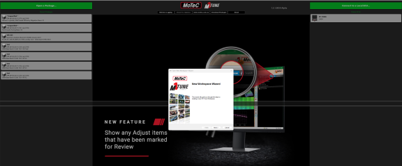

As a bit of extra information for anyone who runs into this.
After installation of the software and the downloading of the templates, you can select the package you wish to open.
If you have never opened a package in Tune 1.5 before, you will automatically get the workspace wizard.
Step 1 - select workspace.png (49.39 KiB) Viewed 14591 times

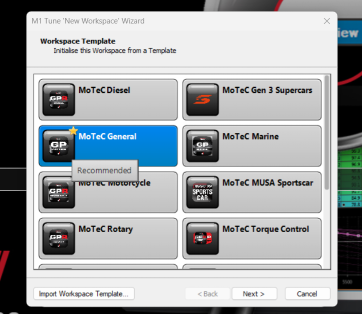

You will click next and then the list of templates you have on your PC will be shown. The best match/ detected match based on our background matching will be shown in blue with a gold star. If you hover over the star it will show recommended:
Step 2 - recommended.png (66.82 KiB) Viewed 14591 times
This is the best match workspace for the package you are using. Please note, this recommended match will only work for MoTeC developed packages. If you are using a partner package (JRR, RNT, etc) you will need to consult them for the workspace to suit your firmware.
