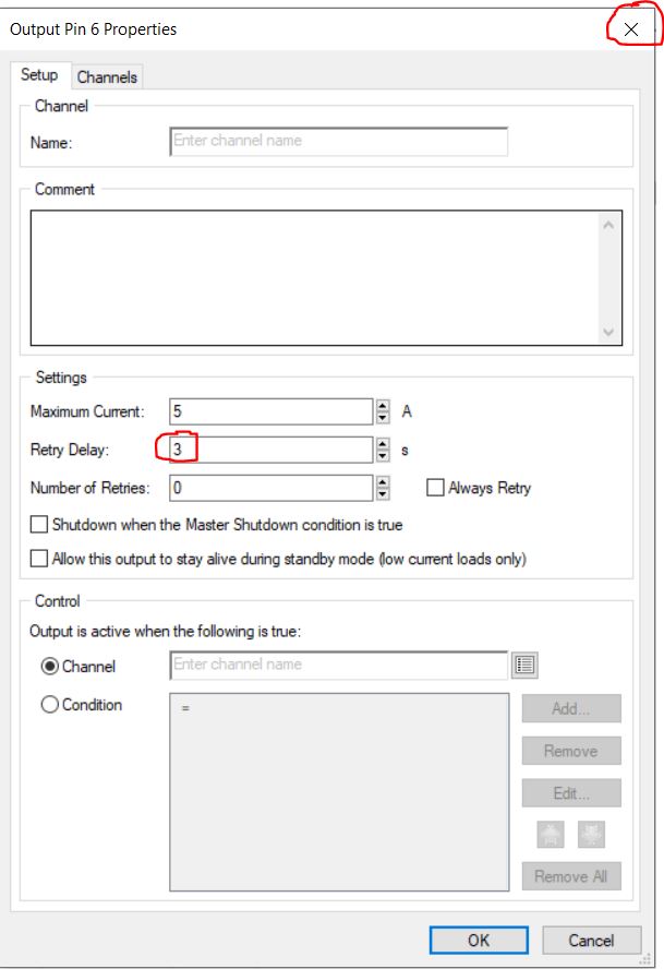

On one of my pc's, I can't edit properties of ex. the output pin.
The main window works fine, but not any of the properties windows.
In ex. output pin the only box can be edited is "Retry Delay"
Even OK og Cancel button doesn't work.

The attached image is the property of an output, on af new config file.
I can only write in the "Retry Delay" box.
And only select the "Close window" (X)
On the main screen, everything works just fine.

Do you happen to use comma's as decimal separators? If so this is a known issue and if you upgrade the latest beta version on our website it has been fixed.

Thanks Adrian
You are a life saver :-)
Yes, it was the problem with the seperator.
I will try the beta version, and change my seperator back to comma.
