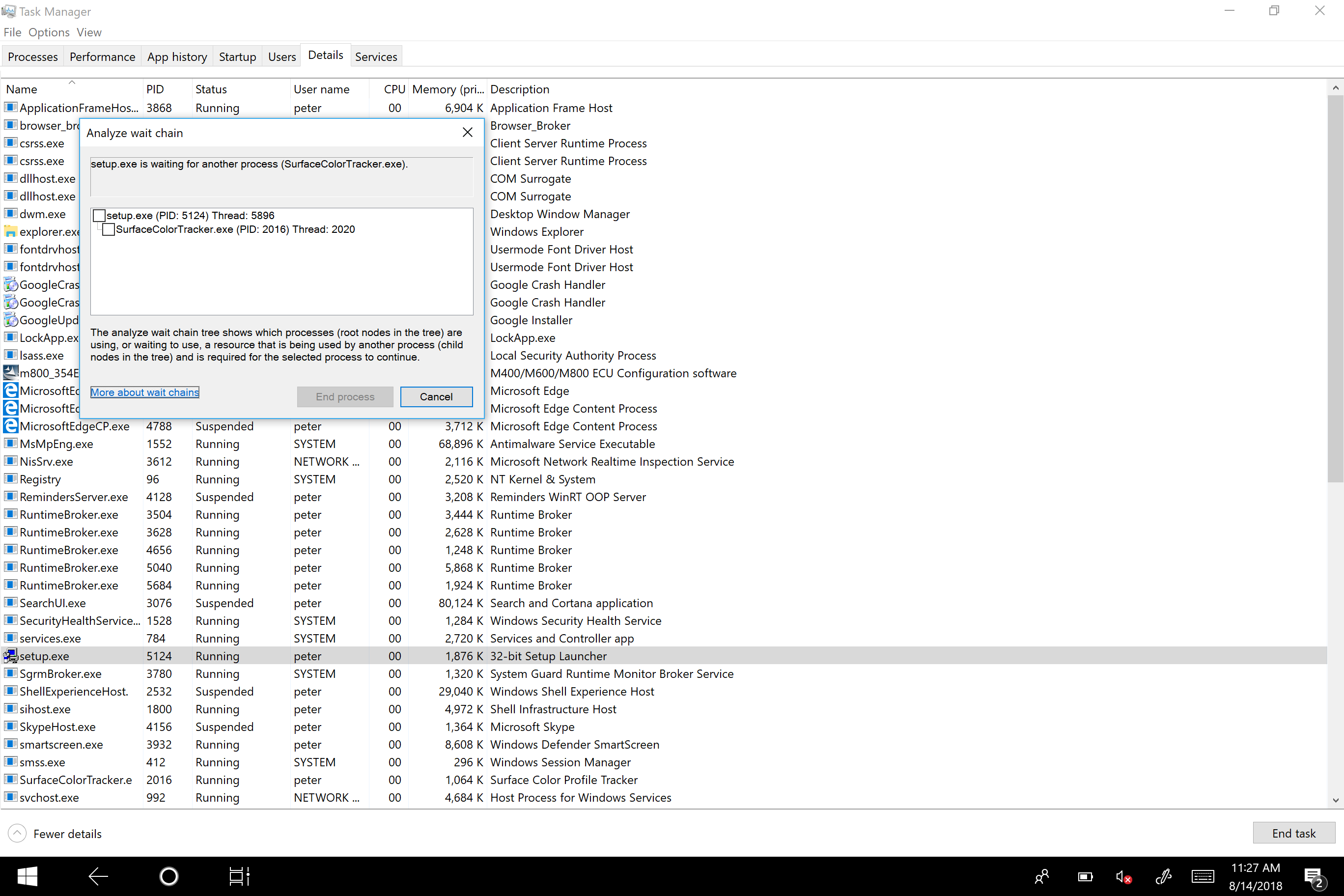

I recently purchased the new Surface Pro (2017) and I found that I could not install ECU manager V3.5 and SDC manager. I found that the install would just hang and never resolve.
I found that the Task SurfaceColorTracker.exe was holding up the install, once I ended the task, the software immediately installed.
