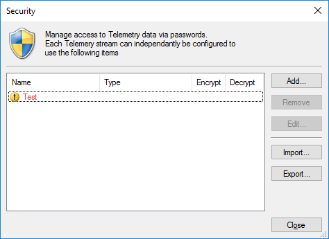

Postby adrian on Wed Jan 11, 2017 8:44 am
That error message simply means that the data stream is encrypted and you haven't put in the correct credentials to decrypt it.
Are you definitely replaying an LD file and not a T2 Image file? The image files can contain security if they weren't decrypted when they were created.
Do you have any encryption being applied to the output stream in T2?
If you click on Security in the telemetry setup in i2, is there anything listed like in the following image?
