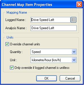

The speed channels logged in an ECU do not have any speed units associated with them as they can be setup in the digital inputs with the calibration value you enter defining whether the result is in km/h or mph.
With this being the case you need to assign units to the channel in i2, you can do this by setting up a Channel Mapping for each channel, go to Tools > Channel Mappings... I have included a screen capture of one I've setup.
i2 Speed Channel Mapping.JPG (20.65 KiB) Viewed 9662 times
Once you have setup the mappings you'll need to reopen the log file and then you can select the channels in the Corrected Speed and Distance calculations.
