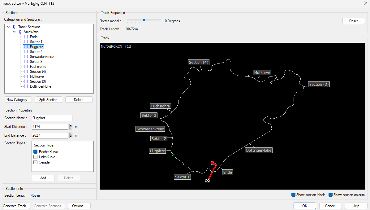

Generate Sections gegraut.png (56.55 KiB) Viewed 14634 times

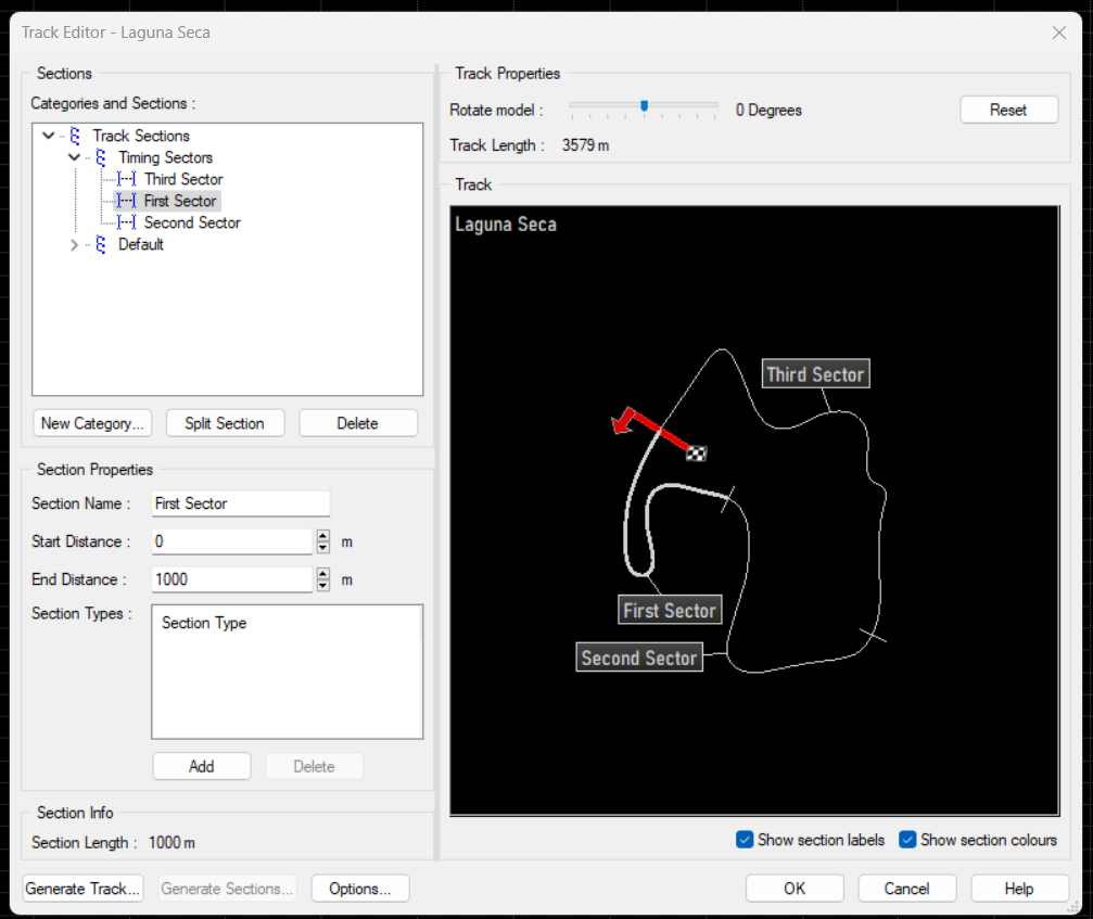

The Generate Sections will generate all the sectors, braking the track map up into all the straights and corners.
Track Sections.png (118.58 KiB) Viewed 8757 times

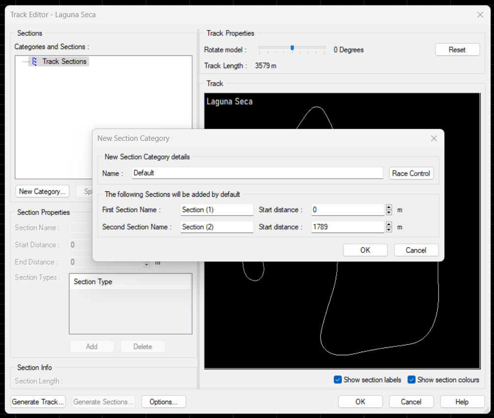

Once your have your track map available, you will want to add a new category with the 'New category' button.
Track Sections 2.png (151 KiB) Viewed 8757 times
For the generate Sections button to work, this MUST be called default. This is because the sectors defined in the 'Default' category are leveraged for several time graph related functions. You don't need to worry about detailing the section names, as these will all be replaced.

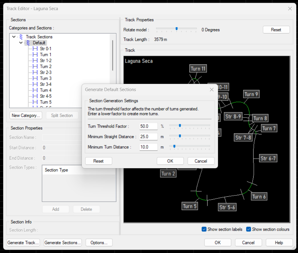

Track Sections 3.png (204.22 KiB) Viewed 8757 times
Now the generate sections button can be pressed, which will break the track up into turns and straights based on the thresholds defined in this section. This will then populate all your straights and turns.

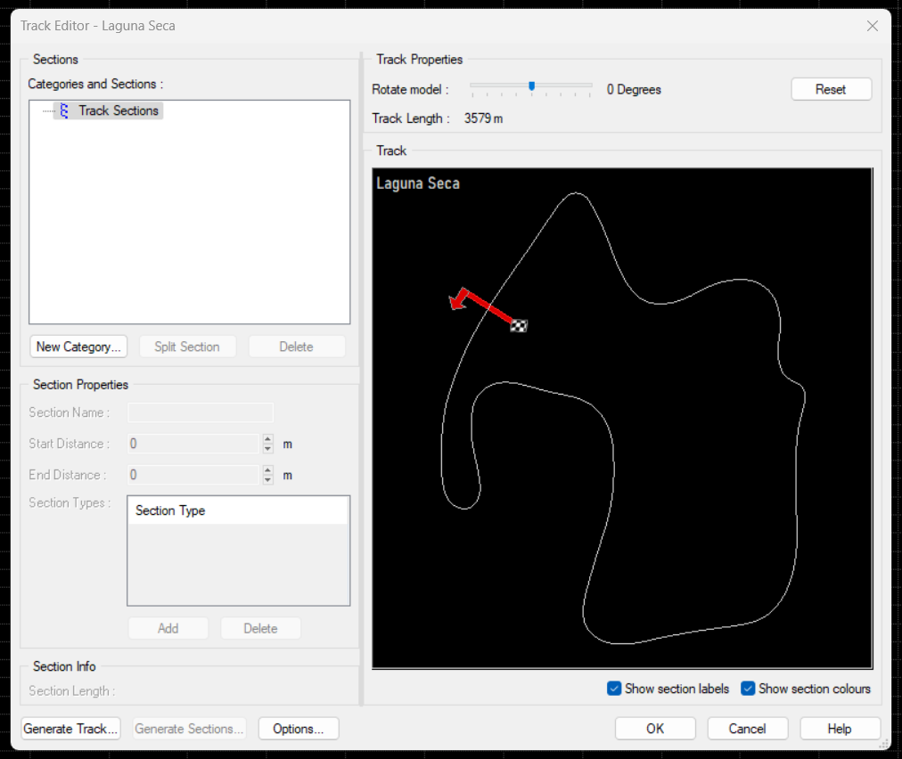

You can also have separate categories for track sectors if you wish additional to the default set. You can then choose which are used for channel and other reports.
Track Sections 4.png (150.43 KiB) Viewed 8757 times
