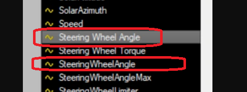

Just to make sure, have you tried both potential channels which are in your list:
*) Steering Wheel Angle
*) SteeringWheelAngle
One is with spaces between words, the other is without:
2x SteeringWheelAngle.png (53.53 KiB) Viewed 9849 times
Otherwise as mentioned before feel free to upload the .ld log file which you are using, attach it here to the forum post, so that others can have a look at it and possibly help you.
