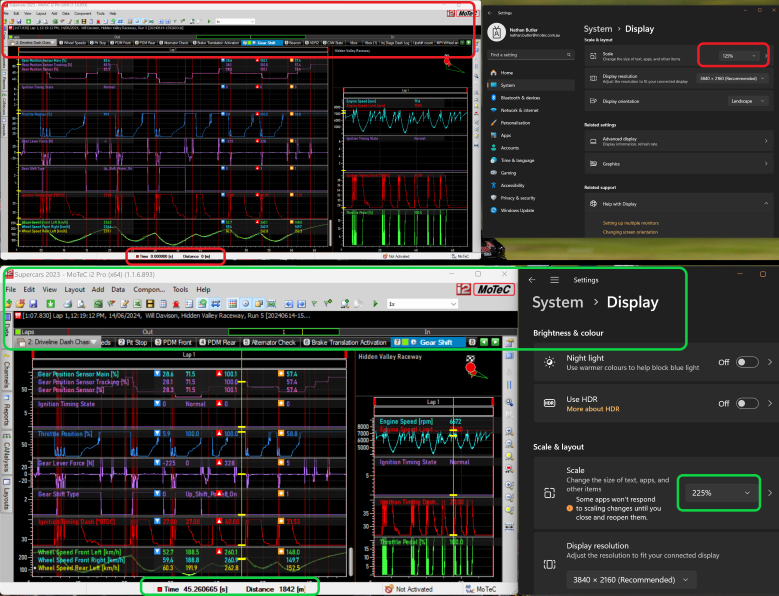

I am using a laptop with a high DPI 14" lcd with a resolution of 2560*1440. To ensure that the image is not too small, I use a scale of 175% in the windows settings (windows 11, x64). It is recommended to use an integer value of 200%, but then it will fit too little on the screen. In any case, the problem exists both on a fractional scale and on a integer scale.
To reproduce the problem, I use the example rally workspace with the example data file (Roger Outback, Belgrave test session).
As you can see in the attached image, the cursor is somewhere in the middle of the session, but the time and distance are not displayed (I have drawn a red line in the image). There is no change when moving the crusor.
If you set the scale to 100% in the Windows screen settings, then everything works correctly.

Checked on version mi2_pro_1.1.6.0887-x64
The file open dialog works strangely.
mi2_pro_1.1.6.0887-x64 file open dialog
Information about the time and distance of the cursor position is not displayed.
mi2_pro_1.1.6.0887-x64 time and distance
On version mi2_pro_1.1.4.0456 everything works fine.

On version 1.1.6.893 still not working.
The file opening dialog looks just as strange, the distance and time are not displayed.
There is no reaction to the message from develepopers. Perhaps I didn't describe the problem clearly enough?

Hi John,
Across all the PC's in our office we are unable to reproduce the issue you are experiencing of the value failing to update.
When scaling is set to a value other than 100%, this does lead to performance issues for some elements of i2 pro. The same can be said for Application DPI settings
Outside of the time graph, items in the task bars and drawing for the worksheet tabs are rendered by windows, whereas components, track map headings, report tables, data and value views all have the font and font sizing controlled in i2 under Tools > Options > Fonts
Rescaling - resized.png (308.66 KiB) Viewed 7157 times
I2 is not a DPI aware program and at this stage there is no plans to try and implement that functionality with the nature of the software (dots and lines) this would be a large body of work to implement.
A typical behaviour is that the time/distance values are slow to update. On my previous laptop (4k resolution screen 150% scaling) if i was to drag the cursor across the time graph, it would update the time and distance values at around 1hz, instead of real time. On my current machine (4k resolution 125% scaling) with more modern hardware i have no change in performance.
As it is not something we can influence in the software (we determine the values, this data is then passed to windows to render which is where a render delay or in your case failure to draw at all) all we can suggest is that:

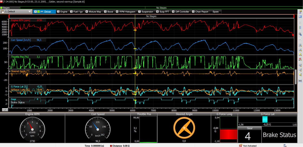

Everywhere there is a problem with displaying time and distance. Time and distance are updated only if you minimize the window to tray and expand it back.
This also works with datum cursor - data update only when minimize and restore window.

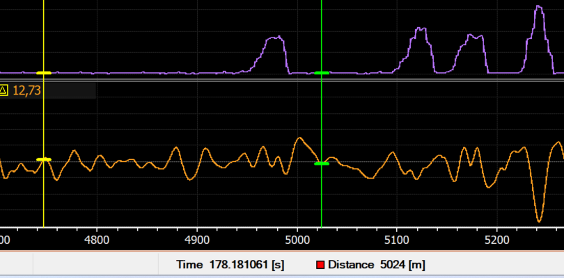

Datum cursor, before minimize:
Two cursor, no data

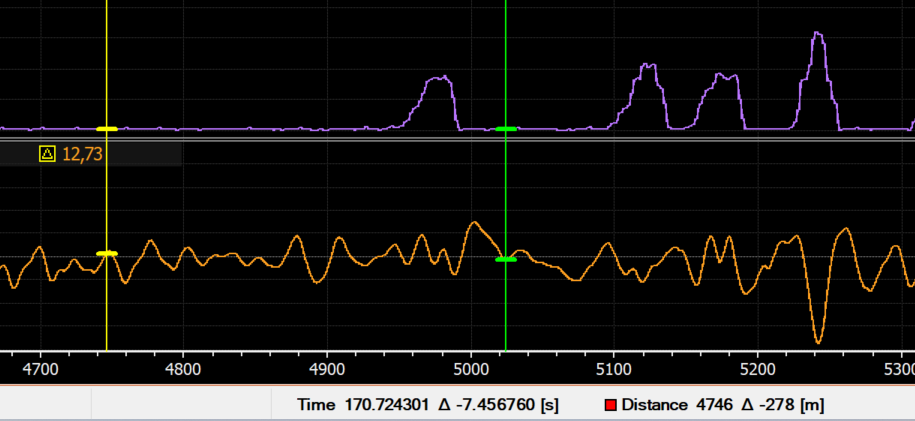

After minimize:
Minimize and restore, data present
The data is not updated slowly, it is not updated at all. Only after the window has been minimized and restored.
