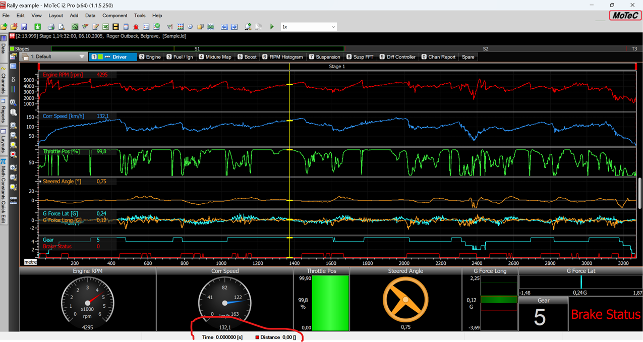

Hello.
I am using a laptop with a high DPI 14" lcd with a resolution of 2560*1440. To ensure that the image is not too small, I use a scale of 175% in the windows settings (windows 11, x64). It is recommended to use an integer value of 200%, but then it will fit too little on the screen. In any case, the problem exists both on a fractional scale and on a integer scale.
To reproduce the problem, I use the example rally workspace with the example data file (Roger Outback, Belgrave test session).
As you can see in the attached image, the cursor is somewhere in the middle of the session, but the time and distance are not displayed (I have drawn a red line in the image). There is no change when moving the crusor.
If you set the scale to 100% in the Windows screen settings, then everything works correctly.
time and distance of cursor position
