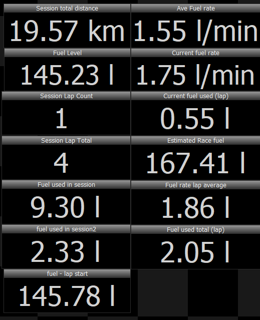

I've done a bunch fuel math previously and rather than copy paste all the calcs, I'll attach the maths file with all the calculations.I recommend you add each one to a numeric gauge and then you can decide what suits your needs.
Your fuel channel will be different in iRacing, so you'll need to update the formulas with the name of your channel. Some of it may need double checking as there was some experimental stuff in there that I never tidied up (was on my todo list - item 483,063 the one after 'fixing the leaky radiator valve' and 'caulking the door frane' :D )
