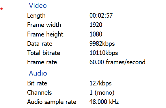

Postby NathanB on Wed Jan 24, 2024 8:11 am
Which version of i2 are you using?
The FFD show codecs are not used for current versions of i2, the display codecs are inbuilt into the software.
As you are on windows 11, is your windows installation set to used balanced/efficiency mode for i2, or performance? This is set via System > Display > Graphics
My only other question would be the video properties for the video file from the smarty cam:
Video Properties.png (11.91 KiB) Viewed 6299 times
Example of an MP4 file from a VBox for reference

Postby ruisoares on Thu Jan 25, 2024 10:13 pm
Näyttökuva 2024-01-25 121101.png (23.42 KiB) Viewed 6257 times
Thanks for the help.
I am using 1.1.5.192 and I made the changes on graphics to performance but issue still there. in terms of video properties:
[img]
[/img]
