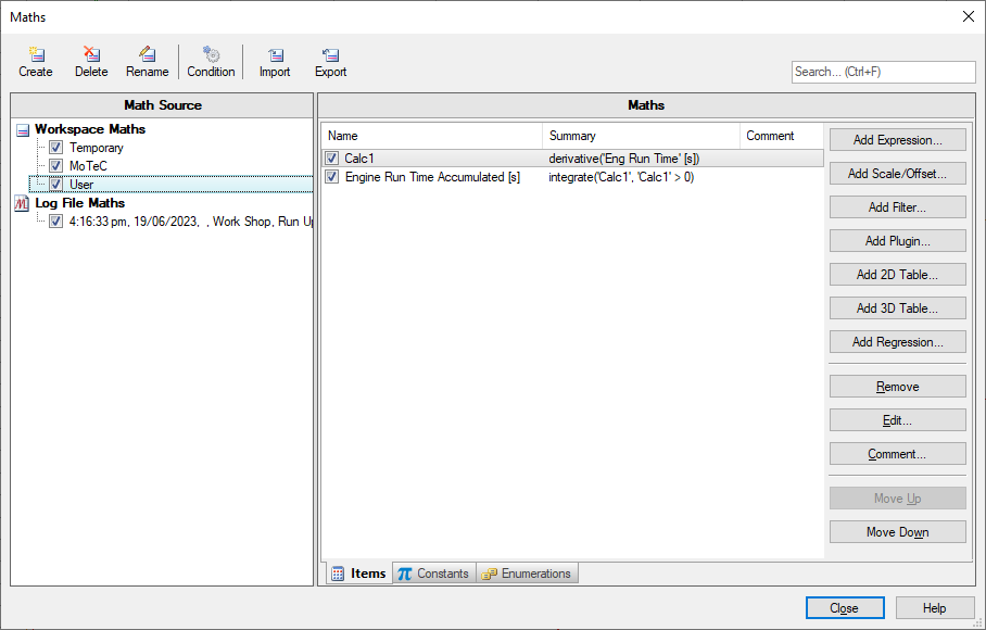

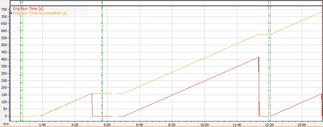

If you're using i2 Pro, you can take the derivative of the channel, then integrate the derivative except any time that the derivative is negative. Make sure you set the calculation rates to the same frequency and it should give you what you're looking for.
E.g:
accumulator result.png (17.31 KiB) Viewed 4832 times

Postby jwickman on Thu Jul 06, 2023 12:37 pm
Hi Malcolm,
Unfortunately im not using the Pro version. Im guessing i need the advanced maths functions to be able to do this.
