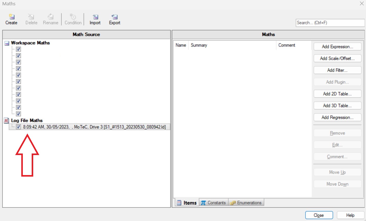

Postby NathanB on Tue May 30, 2023 2:34 pm
In the maths window there is workspace maths, and log file maths.
Anything put in the log file maths is stored in the .ldx file for that log.
Maths window.jpg (97.12 KiB) Viewed 6784 times
