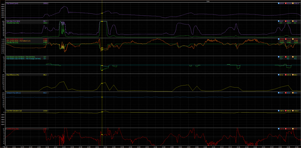

Ok, so with the M1 ecus, you will want to log the following channels at the following recommended rates:
Engine Speed - 50hz
Exhaust lambda (as required, and depending on what sensors are fitted) - 50hz
Exhaust lambda normalised (the calculated lambda before any closed loop trimming is applied) - 50hz
Fuel mixture aim - 20hz
ambient pressure - 1hz (5 or 10hz if you have a sensor and the ambient isn't derived by the estimate)
Inlet manifold pressure - 50hz
inlet manifold pressure estimate - 20hz
throttle position - 20hz
closed loop bank n trim (bank 1 and bank 2 if a v engine/ if fitted)
closed loop bank n trim average (this channel only works if logging was done whilst no pc connection was active. It will tell you what the average closed loop trim was in the active load site)
closed loop trim min / max - 10hz
closed loop period - 10hz
closed loop state - 10hz
for your workspace in i2, you can also do a simple maths channel to work out how far away the lambda was from the fuel mixture aim, however this will not take into account the closed loop period (the delay between the combustion leaving the chamber and being read by the sensor.
Maths example: ( 'Fuel Mix Aim' [LA] - 'Exh Lambda Bank 1 Normalised' [LA] ) * 100
Otherwise, where possible, having a laptop plugged in and connected to the ECU with M1 tune open, going for a drive, and then reviewing the paused data in tuned and making alterations with the "Q" function on the efficiency table is quite effective, as you have the benefit of the crosshairs to tell how well you were lined up with a load site.
fuelling data from logging.png (101.01 KiB) Viewed 6394 times
