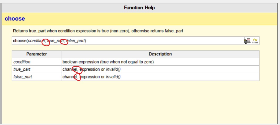

Unfortunately in this particular instance of the language decimal separator issue will not be fixed, as it is embedded in the math engine itself.
Unlike other instances like PDM where due to the script being auto populated apart from the channel values themselves in i2, the script is looking for specific symbols for the expressions and therefore cannot be changed without rewriting the entire maths script for i2.
Maths logic.jpg (64.91 KiB) Viewed 7287 times
This may change down the line, but at this stage, the only way maths can function is with a period for the decimal separator and commas used for the end of expressions.

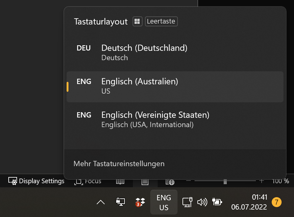

I was able to work around the issue and get a "." to be accepted and entered in the constants by changing the keyboard setting to an english keyboard.
Screenshot (61).png (1.57 MiB) Viewed 7239 times
I understand this is not an ideal solution, and has other complications, but it is the only workaround I have to offer at this stage until a fix is implemented. You can Switch between keyboard layouts relatively quickly using the 'windows' + 'space bar' keys provided you have the additional keyboards available.

Postby Michael on Wed Jul 06, 2022 6:10 pm
Hi Nathan,
thanks for the info! I can confirm that changing to an english keyboard layout is working! That's already something.
