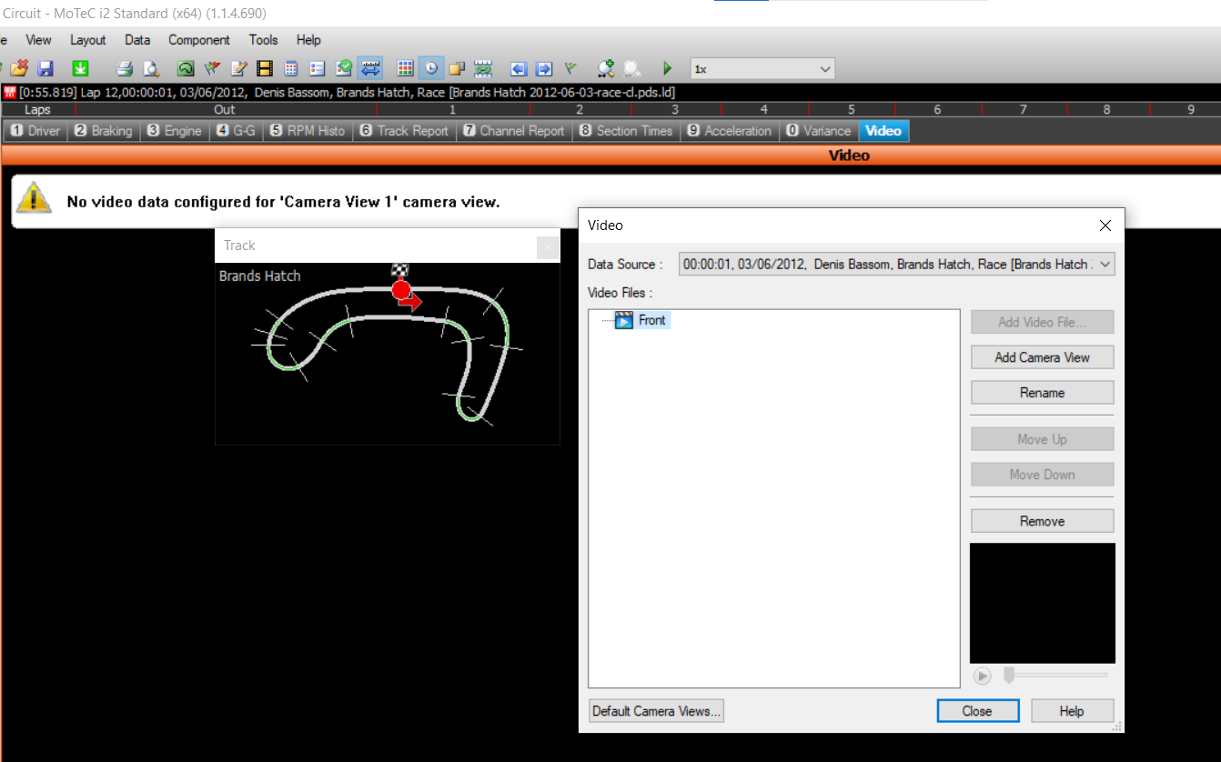

Any idea what I am doing wrong...
The "Add video file" option is greyed out. There is a mp4 in c:\motec\videos. I have data loaded.
Screenshot 2021-08-11 220238.png (150.38 KiB) Viewed 12245 times

Would I be right in guessing it can only show video for data logged with the VCS option or V2?

i2 Standard will only play video that has synchronisation data from the device that created the logging. If you want to play back any video file then you need i2 Pro.

Thanks for confirming Adrian :(
