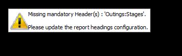

Also each time Channel Report is used in a Rally Project the following error is shown:
Missing mandatory Header(s): "Outings:Stages"
Outing Stage Error.JPG (13.02 KiB) Viewed 4768 times

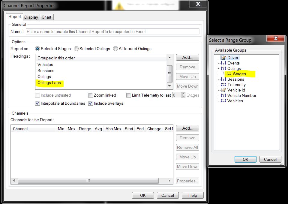

As I understand the error is cause by the default setting in Channel Report Proprieties been set at Outing:Laps in the Headings Options Menu

Thanks for reporting that, obviously it shouldn't be looking for "laps" in a Rally project so I'll get that added as a bug.
