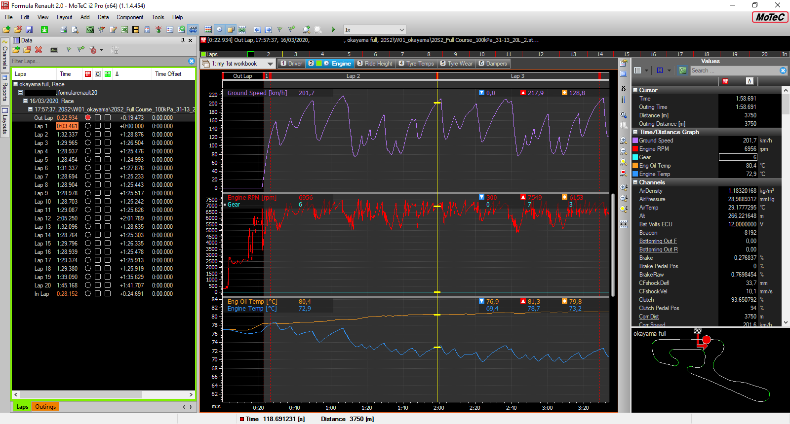

1/ I'm looking for some help to fix the following situation after I recorded telemetry for a race on the Okayama Full Course circuit (see picture1) :
- Outlap shows time spent waiting on the grid waiting for the green light and launch until I reach an unknown marker (?)
- Lap 1 shows time between this unknown marker (?) and the start/finish line
- Lap 2 starts as I cross the start/finish line
- Lap count is thus incorrect (1 more lap counted than what was achieved in reality)

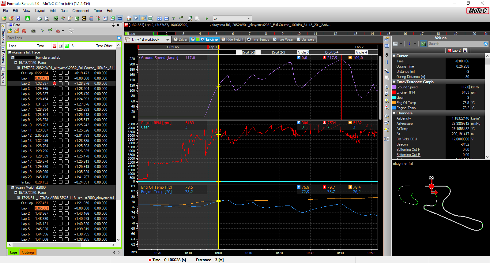

2/ Moreover, if I select "Outlap" or "Lap 1" in the data panel on the left, then end/beginning of Lap 2, 3, 4, ... are all shifted forward on the track representation (see picture2)

Picture 1
Picture 1
Picture 2
Picture 2
