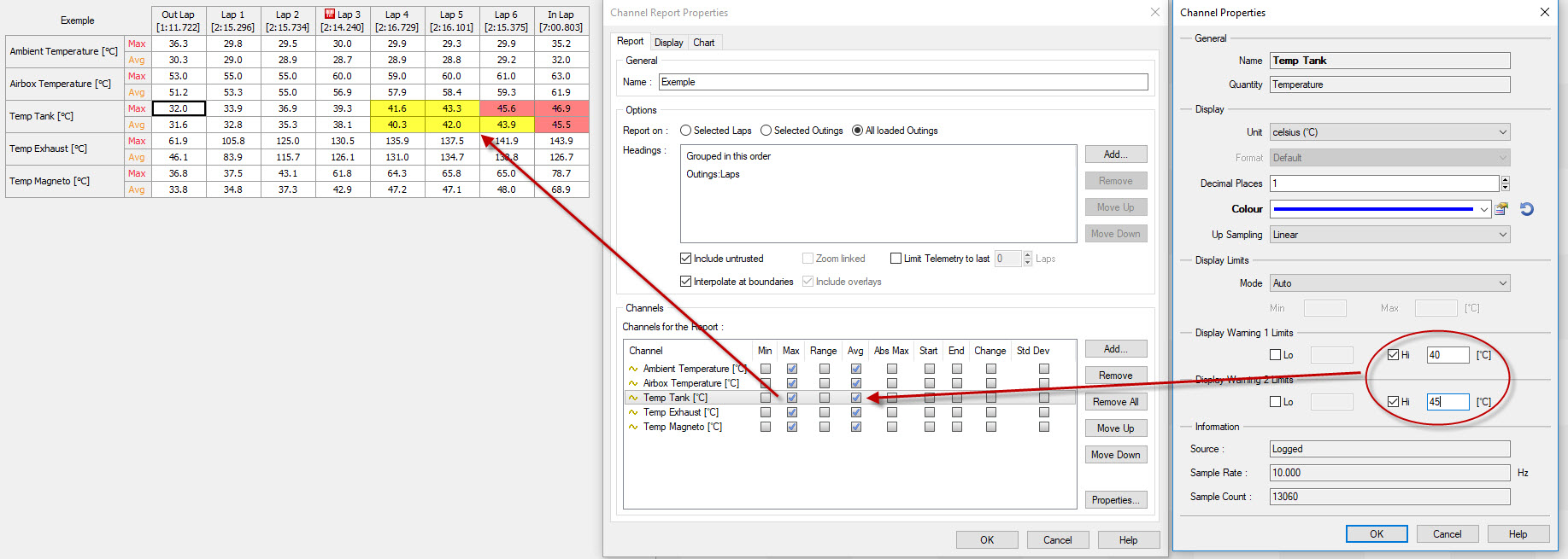

Can someone tell me what is the use of "Display Warning 1-2 Limits" Lo / Hi in the "Channel properties"???
(MoTeC i2 Pro (x64) (1.1.4.454))
Have I look all over the MoTeC literature, notes, help menu, forum and I am unable to find the information. Is it link to the Telemetry Interface?
Does anybody known how to highlight channel over a certain limit in the channel report. I would like to avoid doing some Math channel, I have more than a 100 temperature to monitor.
It would be very nice feature if we could use it in a "channel report" to color value that are over the warning limits. Here is a example.
Warning highlight channel report.jpg (292.45 KiB) Viewed 11900 times
Thanks, Frank

Great idea. I would expect the Display tab of the Channel Report Properties to have tick boxes in the options section with something like:
"Show color Background for Display Warning Limit 1 Lo" + Color Picker Icon
"Show color Background for Display Warning Limit 1 Hi" + Color Picker Icon
"Show color Background for Display Warning Limit 2 Lo" + Color Picker Icon
"Show color Background for Display Warning Limit 2 Hi" + Color Picker Icon

The Display Warning Limits are used when setting up gauges, so for example you can have a coloured 'Zone' on an RPM gauge above the red line.
I think your suggestion is a good one, I will add a feature request to our system.

It occurs to me to ask -- would it be possible to have these limit values show up on the time/distance graphs as well?? Right now I just use a quick constant value math channel to put a reference line on strip charts but that seems like duplication of this capability that's already baked in. Seems like it would be pretty simple to add a couple of check boxes to enable showing these as lines in the properties dialog of the time/distance components and then have the limit lines drawn.
if competitive comparison helps the cause, Pi Toolbox has this already ;)
