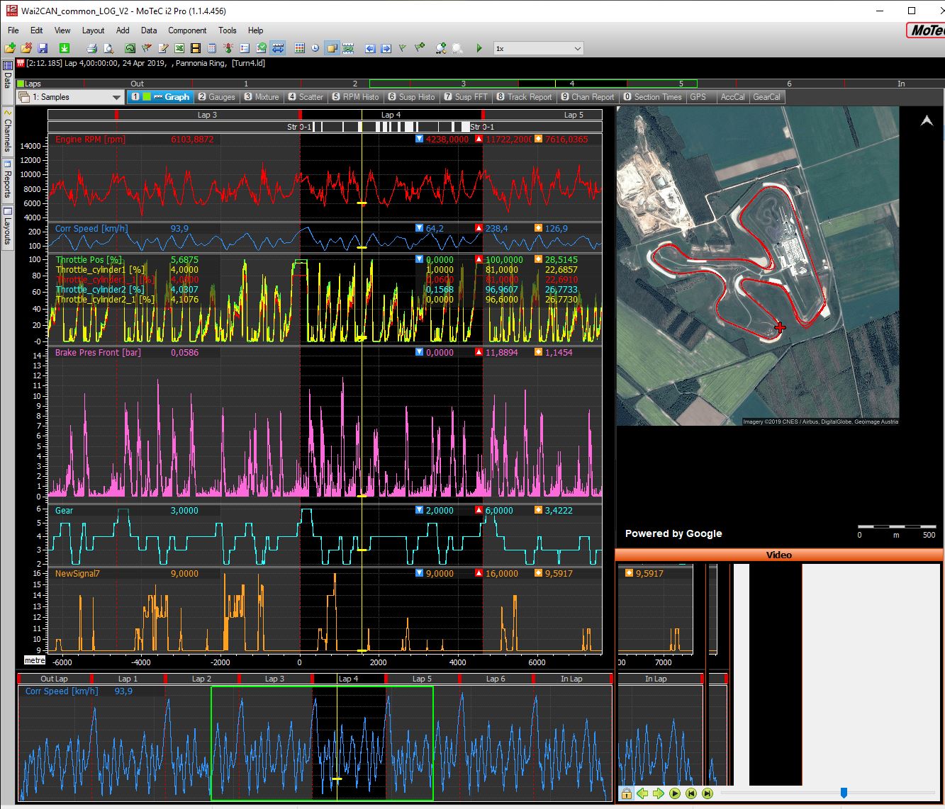

Hello, i need help with this, im using i2 std, c187 and v2 camera, some time ago all was working good, but now i cant see the video, i select any data and is the same with all, i hear the sound perfectly but the video dont work, if i create i new tab in workspace with video, it work, but when i change the highlight tab and come back to the video, again not work and the space for video stay like freeze with the word or image that was on top, if i try the video in other player works fine, already try re install i2 std and ffdshow codecs many times, im using windows 10 64bit. thank you

I'm facing exactly the same problem. First the Video was working fine. but when I re open my recent workspace, the video just stay black. I could here the sound (so I guess i2 knows the correct file). And sometimes, like on my screenshot, the video window just shows artefacts from different screen regons.
