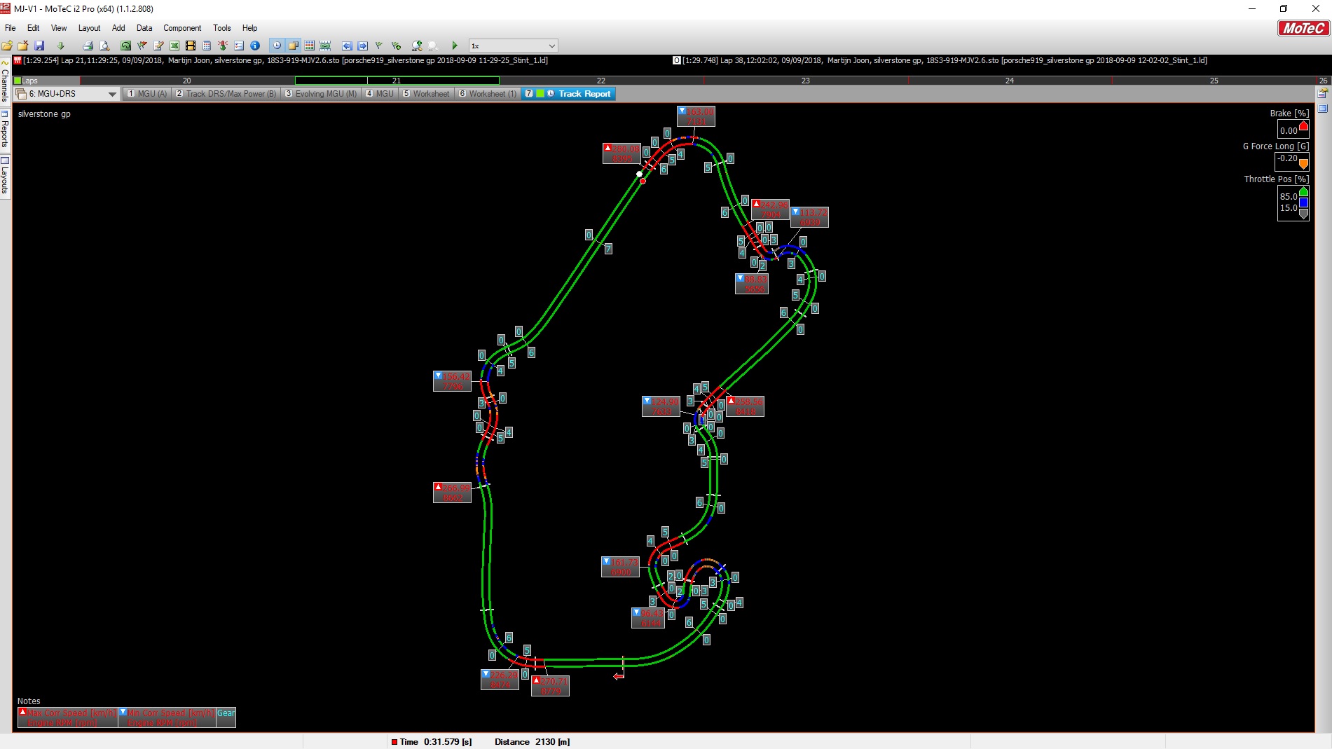

Hello all,
In the attached screenshot i made a track report. Now i'd love to see the difference for example top end speed on the selected lap and the overlay lap. Is there a way to do it? I know the small red triangle says the overlay is for example an higher speed but not by how much?
Thanks in advance all!

At the moment the only way you could do this is to create a maths channel that is the speed difference between the main and overlay. So something like this:
Speed Difference [km/h] = variance_dist('Corr Speed' [km/h])
Then in your track report you add a note for your maths channel and have it calculate at the end section.
I have added a feature request ticket to our system to build this functionality into the track report itself so you don't have to make maths equations.

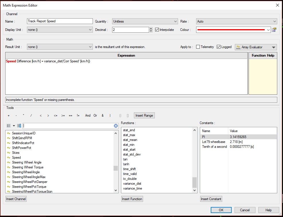

Postby Martijn on Wed Sep 12, 2018 7:57 pm
THanks for de quick response Adrian. I'm not very good at maths in MoTeC (working on it... :) )
I get this, what am I doing wrong?

Postby adrian on Thu Sep 13, 2018 9:52 am
You don't need the 'Speed Difference [km/h]' part in the expression. Your 'Track Report Speed' channel is the resulting channel.
