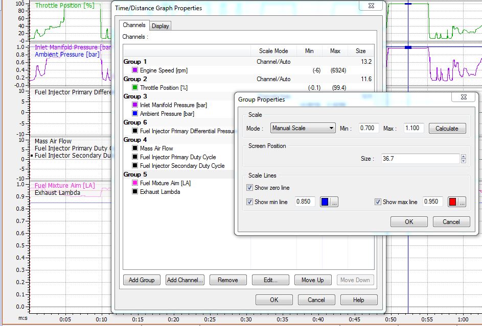

This is setup in the properties of the Time Distance Graph. Right click on the graph and select Properties... Under the channel tab, you can edit the scale of a group, or an individual channel (which may affect it's scale everywhere it's used with Channel/Auto group scaling). Here is a screen shot where I'm changing the scaling for the Fuel Mixture group (Group 5) to show the real area of interest:

Yep, works.
Great, thanks,
