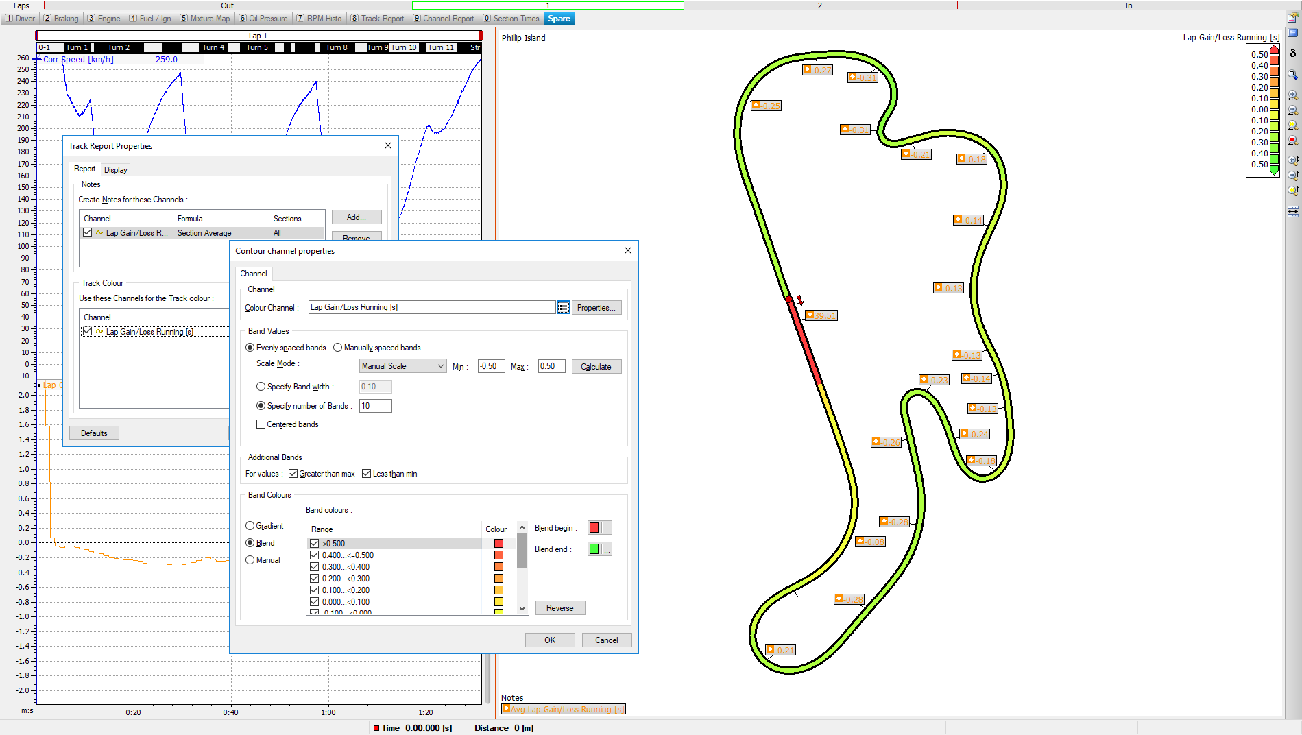

I'm still a beginner and get stuck at the moment while trying to create a Gain/Loss rainbow track map between the two selected "Main" and "Overlay" laps. Searching through the forum and the www didn't help so far.
Mainly I would just need the "Variance" Channel with the Values that you see when pressing F3, but that seems not possible.
Thanks in advance for your support!

I am not sure exactly what you are trying to do, are you wanting to label or colour the track report with the Lap/Gain Loss running values?
Re: Time Variance Gain/Loss rainbow track map
PostPosted: Mon Aug 07, 2017 6:32 pm
by rosicky
Yes, exactly !
PostPosted: Tue Aug 08, 2017 9:35 am
by adrian
Below is an image with a track report that is coloured and also labelled using the Lap Gain/Loss Running. The two windows show the settings I used. You can manually adjust all of the colour bands to make it look more distinctive if you wish.
Lap Gain-Loss Track Report.png (117.99 KiB) Viewed 30148 times
