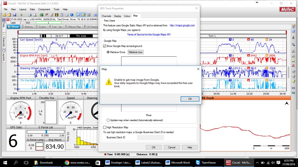

Hi all,
I'm using i2 1.1 and am wanting to download the map background from google maps but get the following error (see image).
Any suggestions to fix?

Postby donaldboyer on Wed Sep 28, 2016 5:28 pm
28/09/2016 7:28:21 PM: Retrieve Google Map: https://maps.googleapis.com/maps/api/st ... nsor=false

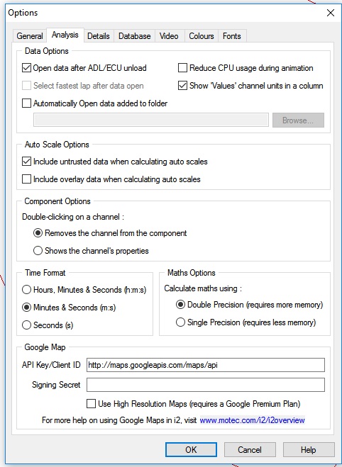

Postby adrian on Wed Sep 28, 2016 6:22 pm
If you go to Tools>Options and then the Analysis tab does the URL at the bottom match the one in the screen shot below.
i2 Google Maps.png (78.24 KiB) Viewed 26842 times

Postby adrian on Tue Dec 20, 2016 8:16 am
The location for entering the API key/Client ID has moved from the GPS Map properties to Tools>Options and then the analysis tab.

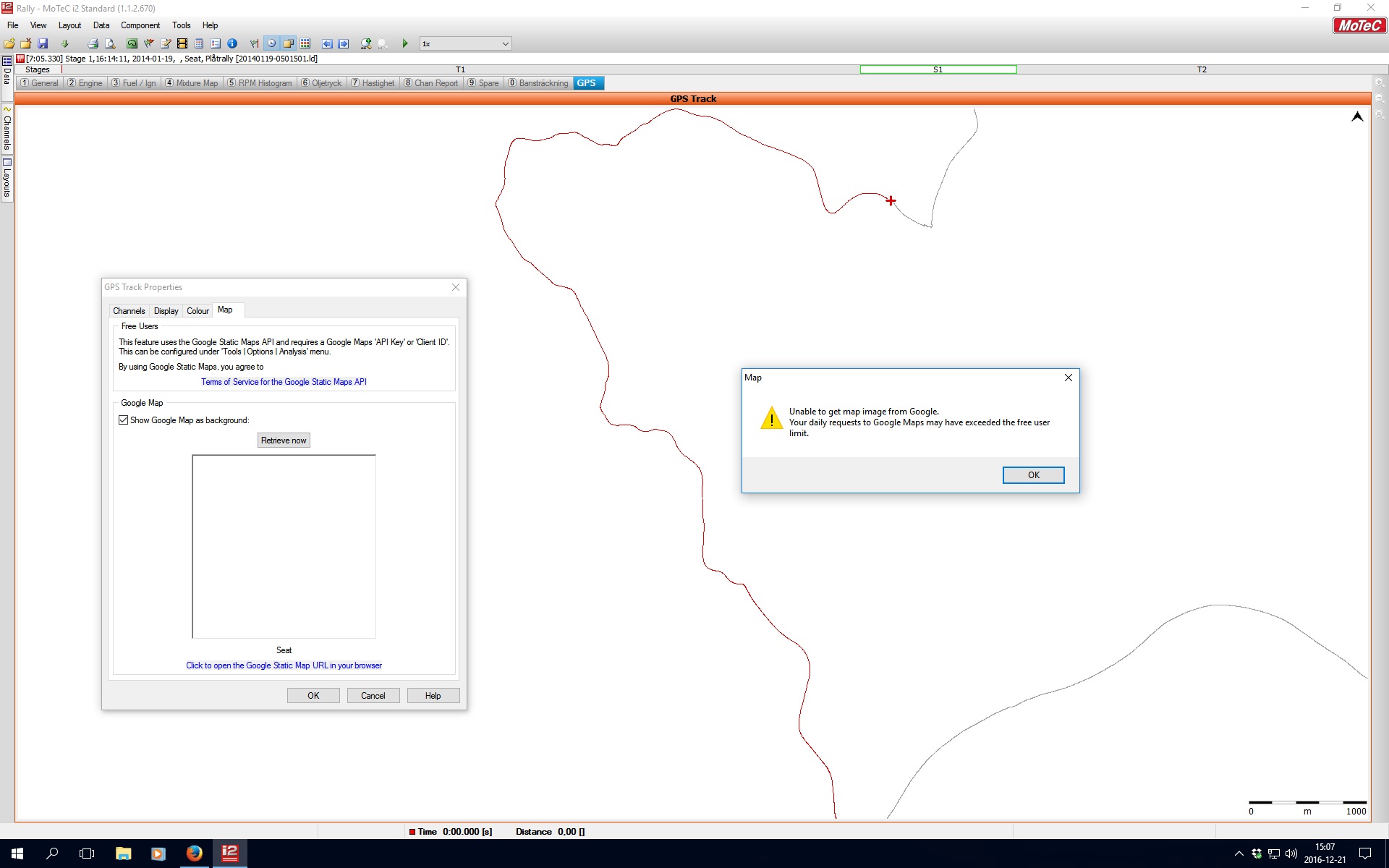

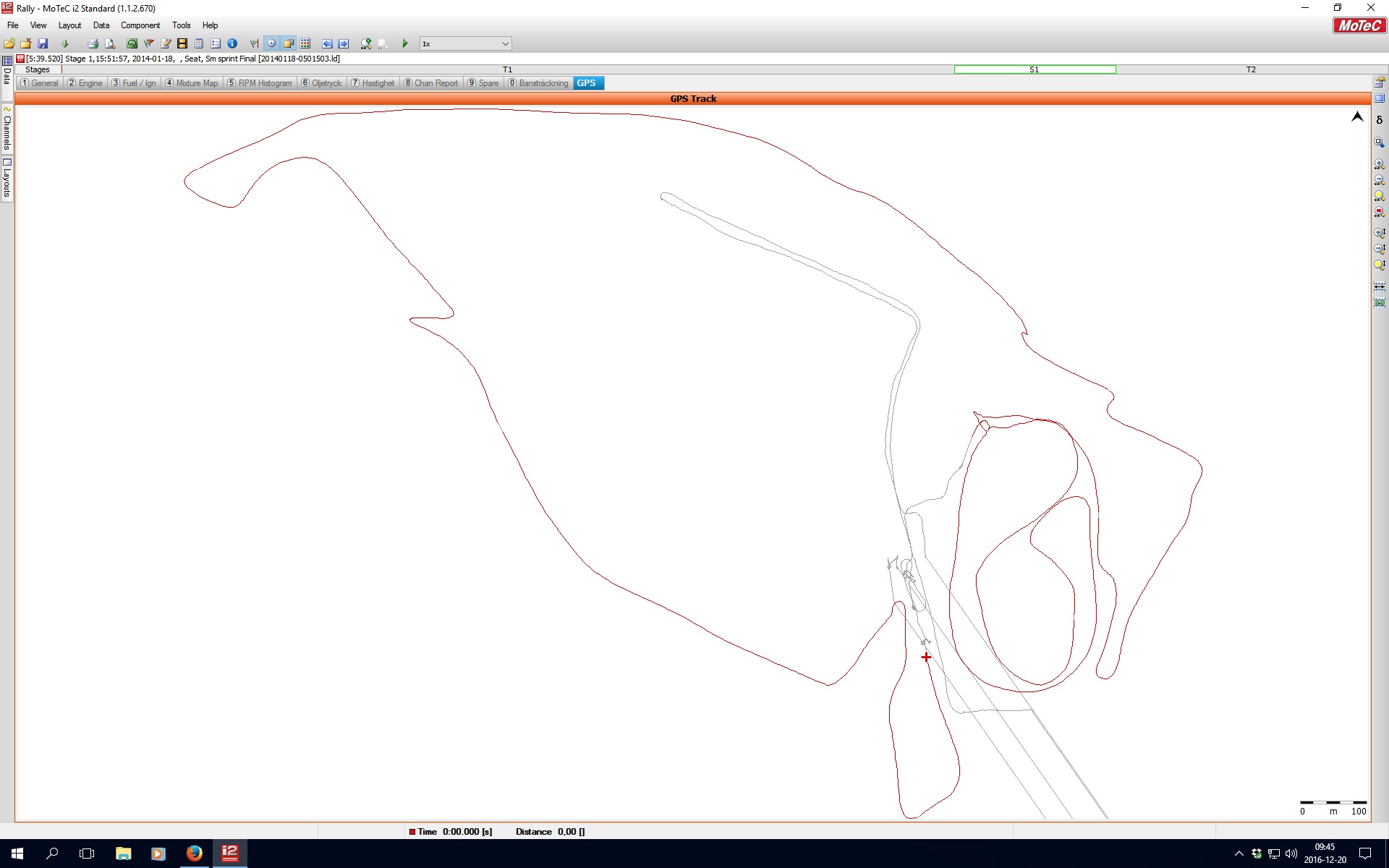

Postby super7 on Tue Dec 20, 2016 8:00 pm
Motec i2.jpg (114.69 KiB) Viewed 26667 times
Motec i2.1.jpg (226.78 KiB) Viewed 26667 times
No Google map.
What's wrong?

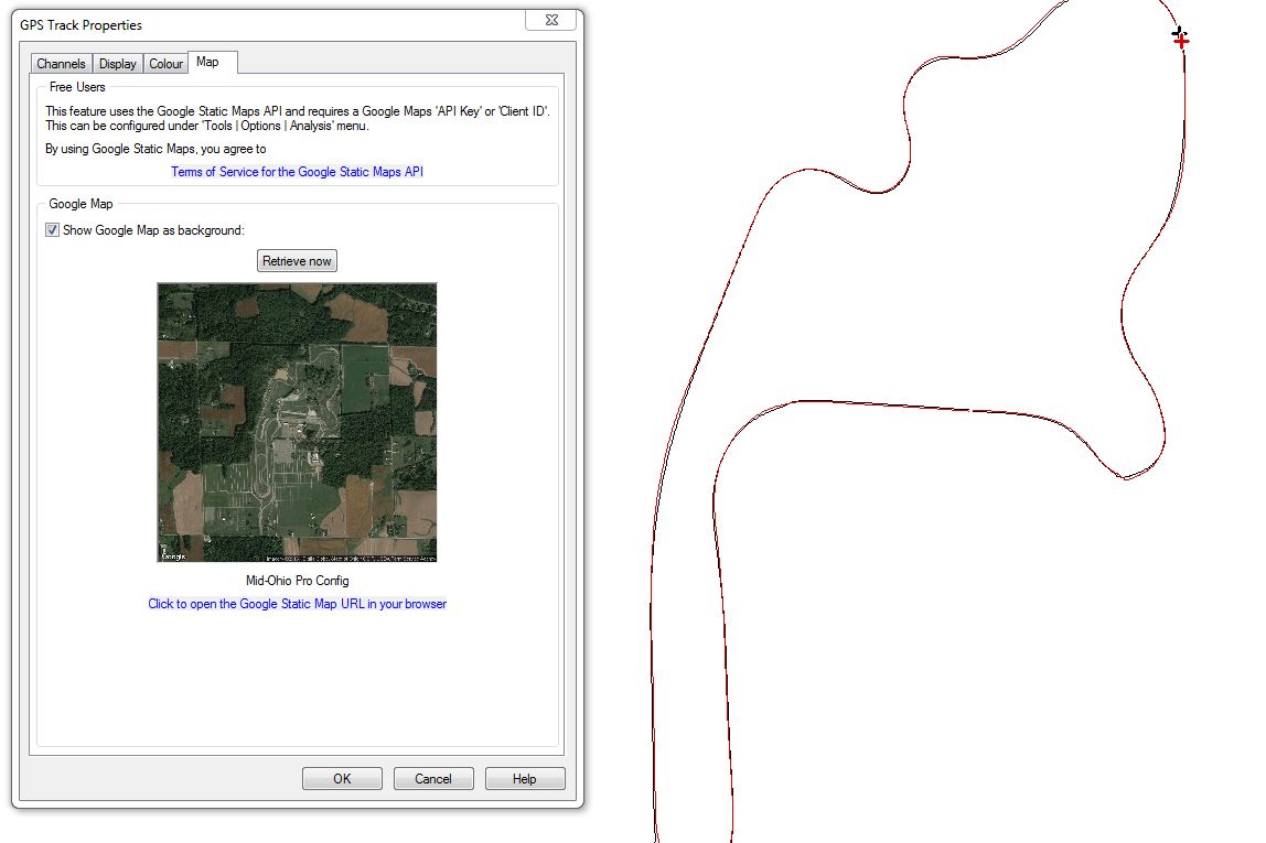

Postby David Ferguson on Wed Dec 21, 2016 5:40 am
Have you right-clicked on the map and selected Properties->Map then clicked the "Retrieve now" button?
GPS Map Properties
Retrieve now.JPG (90.08 KiB) Viewed 26661 times

Postby super7 on Thu Dec 22, 2016 1:20 am
Motec i2.jpg (245.56 KiB) Viewed 26637 times
What's wrong?

Postby David Ferguson on Thu Dec 22, 2016 4:25 am
My Tools->Options...->Analysis->Google Map API Ken/Client ID field is empty (it has placeholder text saying "Client ID must start with gme'").
The Retrieve Now button works for me in the US.
