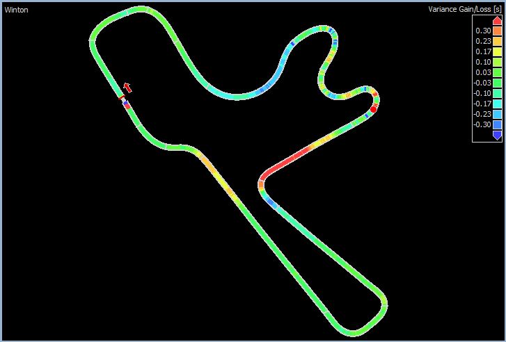

Postby DarrenR on Tue Jul 20, 2010 10:02 am
The variance calc is the time difference at the same track distance from main to overlay. It's running lap/gain loss. taking the derivative of the variance shows time gain/loss per second. If you then use this channel for colour on a rainbow track map you can instantly see where you were faster and slower!
Yes a variance channel could be made with a custom function.
This is some of my data from the Winton fun day. The big variations are because of traffic but the two laps were a similar time. So you can see at the end of the old straight i was going more that 0.3sec/sec faster on one lap to the other, but on sweeper about the same amount slower.

Postby richib2002 on Wed Jul 21, 2010 2:27 am
Hi Holmz:
As Darren has shown. if you could calculate the derivative of variance and display it on a rainbow map it would be an excellent way to quickly show a driver where he was faster and to what degree when comparing 2 laps.
