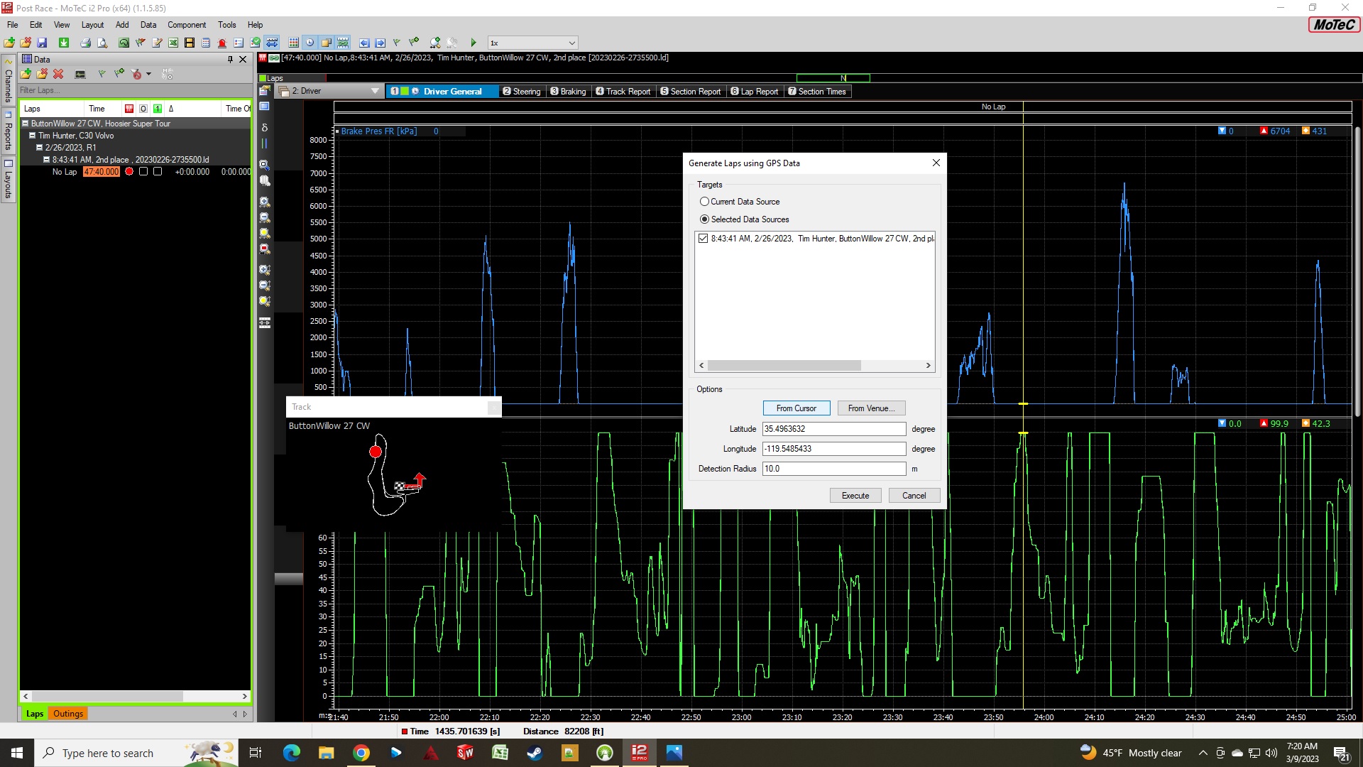

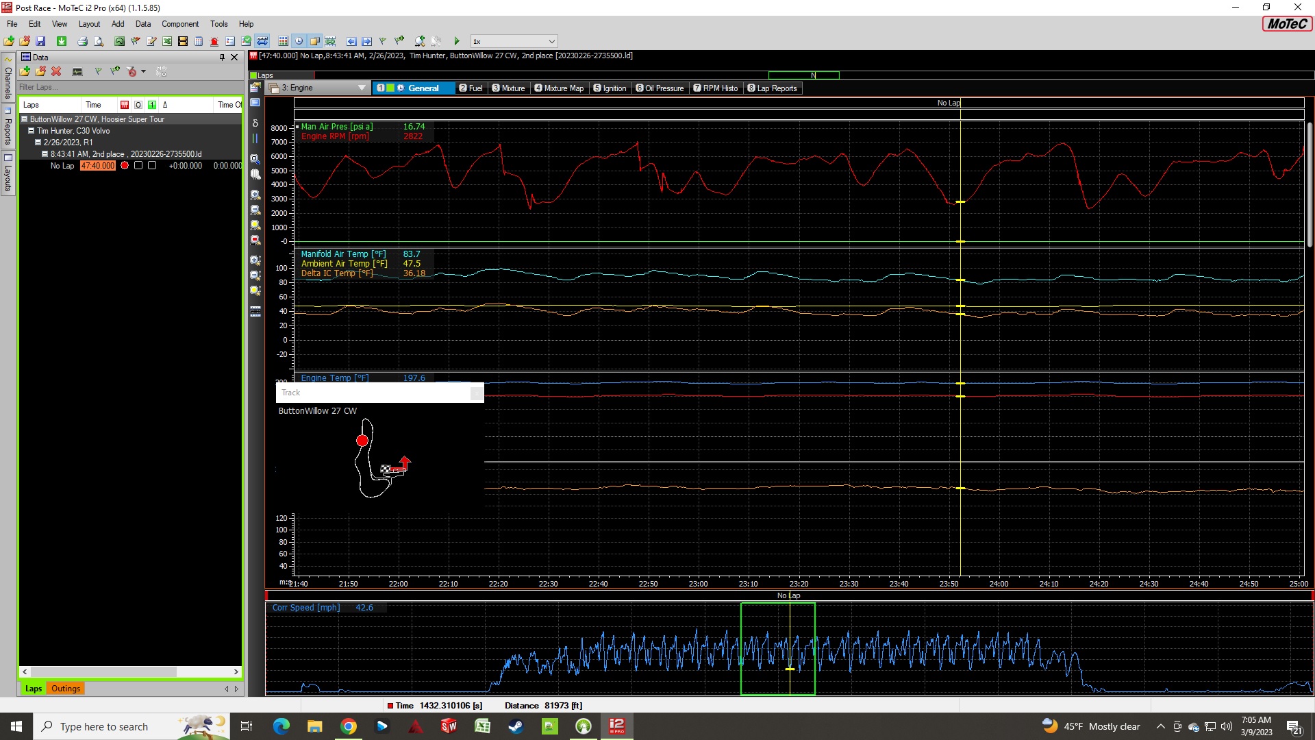

Postby timlhunter on Fri Mar 10, 2023 2:35 am
I generate the track and get the following track
Generating Track
Generate Track.jpg (605.11 KiB) Viewed 7775 times
I generate the laps using the the method you outline and get the resulting laps, but the start line is still in the wrong place.
Generating Track
Which gives me the wrong track, see the inset map and the lap is going through the hot pits because the start finish line is in the wrong place still
Generating Track
So even setting the cursor on the screen or typing in the coordinates still gives me the incorrect start/finish line. Any help is appreciated.
Resulting Lap Map.jpg (589.56 KiB) Viewed 7775 times
Generate Laps.jpg (569.57 KiB) Viewed 7775 times

Postby Stephen Dean on Fri Mar 10, 2023 10:18 am
If you view the GPS Track, does it have the S/F line in the correct location?
