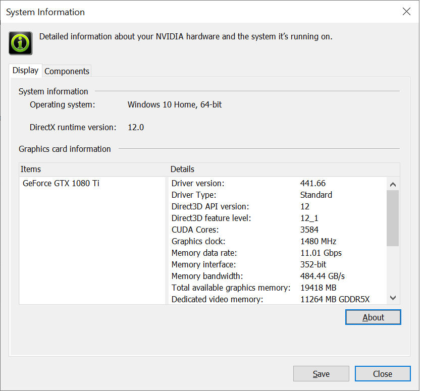

Good to know -- thanks, Stephen! Happy to do scenario testing if you need something checked.
In case it helps, here's the info on the card that I have in the system experiencing the problem and the associated driver version (...which is latest qualified right from the NVidia site).
