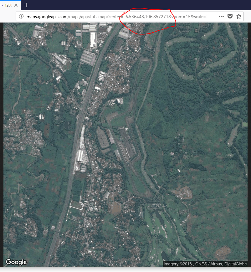

I've tried to add a GPS track following the conversation in the thread.
When I tried to retrieve the circuit's map using Google's map retrieve function in MoTec,
a hyperlink with the message "Sorry, we have no imagery here." came out.
Upon checking the longitude and latitude values of the static map, it looked like MoTec is using the wrong values.
I manually corrected it and I was able to obtain retrieve the correct image.
Please see attached files for reference.
However, I can't load it as a background in the GPS track.
My question is how can I set (or override) MoTec to retrieve the correct map using the correct longitude and latitude values?
Please help me.
Correct longitude and latitude values
MoTec default(?) longitude and latitude values

Postby adrian on Thu Feb 01, 2018 10:00 am
Can you please do a test for me.
In i2 go to View>Messages. Now go to the GPS Track properties and reload the image.
Now click on a time/distance graph and press F2. Go back to the properties of the GPS Track Map and reload the image again.
Right click on the messages window and copy to clip board. Then paste the messages here.
Can you also please let me know what version of i2 you are using.
