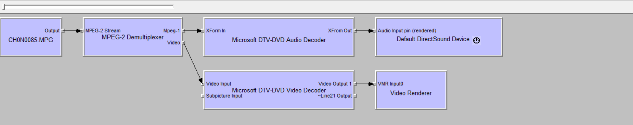

Below is a link to a program called graphedt, it basically shows you which codecs are being used to play the video.
Can you please download it, run the either the 32/64bit versions depending on your PC, drag and drop the video file you are having issues with into it and then post a screen shot of the block diagram up here.

OK here it is. Hopefully you can see it.
Motec Video File Screen Shot
Motec Video Screen Shot.PNG (64.24 KiB) Viewed 22898 times
